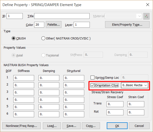

CBUSH or CELAS elements are often used with two coincident nodes.
But how is this possible, as the stiffness values are of the unit N/mm?
I do not understand how there can be a stiffness applied, when the spring has a length of 0.
Thanks for your answers in advance!
RE: CBUSH coincident nodes
Dear Alphamax,
CBUSH is a structural scalar element connecting two noncoincident grid points, or two coincident grid points, or one grid point with an associated PBUSH entry. This combination is valid for any structural solution sequence. The use of CBUSH element has all advantages over CELASi elements. For example, if you use CELASi elements and the geometry isn’t aligned properly, internal constraints may be induced. The CBUSH element contains all the features of the CELASi elements plus it avoids the internal constraint problem.
The Orientation CSys option defines the CBUSH element coordinate system for the element referencing this property, allowing to use two coincident grid points for the element definition. If the Orientation CSys option is off, then Nastran will determine the element coordinate system from the orientation defined on the element.
