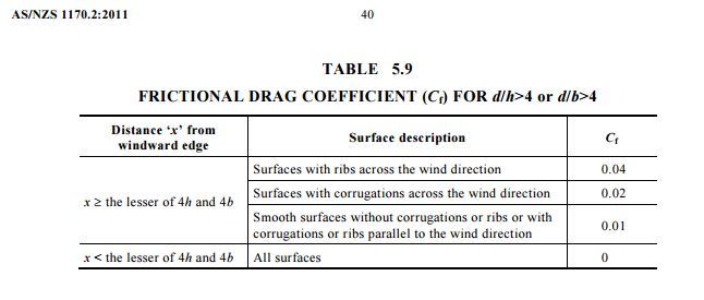

Is there a way know how much load should be applied to parallel-to-wind surfaces of a building system when the cladding is corrugated metal? My question specifically relates to wind acting parallel with the ridge of a building. The load has to be more than the wind pressure acting on the cross-sectional width of the building I believe, but not sure how to consider that. Does anybody know how something like that can be figured? Is it some "surface roughness" characteristics that can or should be considered? Is there a ratio of cross-sectional endwall area to length of building that could be utilized?
And then................what if the sidewalls of the building are open? How does wing load hitting the webs and chords of trusses impact the overall lateral loading on a building? To sum up the surface area of every truss in the building and apply load over that area seems overkill as no doubt there would be lots of turbulence created as wind would rush through the trusses. Not sure how to think about that either.

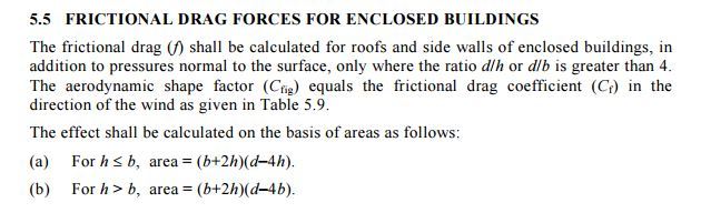

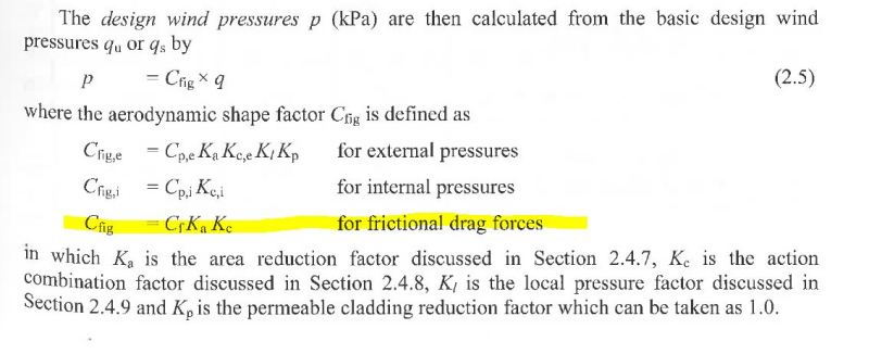

I've participated in a similar discussion here in the past. Apparently, Australia has a provision for wind drag on parallel surfaces which makes a ton of sense to me. In the past I've pretended that parallel to wind surfaces were pitched at 15 degrees in order work out poor man's version of a drag load.

@KootK,
Thanks for the lead on how the Australian code handles wind frictional forces. bigsmile

KootK: Correct, Australia has all things that are good.
OP - I'll scan the relevant page from our portal frame bible in the morning for your reference.
RE: Drag loads on corrugated metal roofing and siding
See below. However in the worked solution in the textbook, the frictional drag forces make up just over 7% of the total lateral force at the ridgeline... therefore I wouldn't worry too much, unless you have a really long building or massively ribbed cladding.
