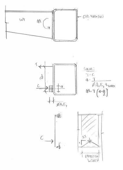

Hi all,

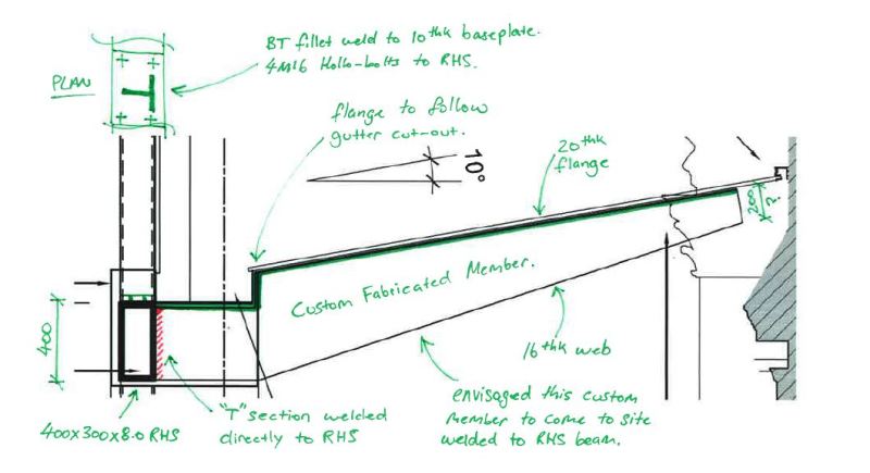

Currently going through the design of the glazed roof system, as shown below.
In particular, I'm having a good look at the connection of the cantilevered/tapered "T" member (multi-coloured 380BT) coming into the main beam(grey 400x300x8.0 RHS).
I would like to check the capacity of the RHS side wall if I were to directly weld the "T" member. Note I've used the plastic section modulus for the RHS side wall.
My design philosophy so far: Would be great if anybody could provide some feedback on my philosophy and/or ideas about this connection.

I believe that the method that you have proposed is reasonable and, as you are finding, probably rather conservative. The only change that I would suggest is that I would call the side wall pinned rather than fixed. There is some fixity, of course, but it will be partial and a pain to assess.
Most of the compression force will be concentrated close to the tip of the WT stem because the side wall will be stiffest there. As such, you're going to get a tension force very high on the RHS side wall and a compression force very low on the RHS sidewall. That should greatly reduce the flexural demand on the RHS side wall and simultaneously increase the local demands on your welds (unless you're claiming compression bearing at the stem tip).

Hmmmm, I suppose it comes back to the good old engineering judgement.
I understand where you are coming from regarding the tens/comp forces will tend towards the RHS return sidewalls.
If the sidewalls are pinned however, it also increases the flexural demand on the plate element in question...
Would a reasonable solution be to weld the T section to say a 16mm plate, which is then welded onto the side of the RHS?
Would be good to hear from anyone who has done a similar connection.

I wouldn't do this. The CHS wall shouldn't be the limiting factor here. It should definitely be possible to make this work with a direct weld.

No doubt one could class this up with the right yield line model.

Thanks for the sketch, KootK. Throwing a spanner into the works here, but I forgot to add there is a nice cutout for the gutter in the T section.
All along I've assumed the bending stresses can 'follow' the flange around the cutout, as the section actually gets deeper than 400mm... How would one check this though?

I think you should consider bi-moment in RHS due to non-uniform torsion and warping effect.

Without introducing web stiffeners, it would be very difficult. You get cross flange bending and concentrated web loads at the flange knuckles. I would try to make it work using just the web section strength at the flange knuckle locations.

When I've done something similar in the past I've also checked the bearing on the RHS (especially at bottom flange). Your code probably has equations for bearing on hollow sections for a concentrated load acting over a bearing length, and for resultant combined stresses from bearing and bending in the RHS.
Some sort of check for the transverse and longitudinal stresses in the RHS is also warranted at the connection. At the top and bottom flanges the flange forces result in a tension/compression across the RHS flange that must be combined with the normal longitudinal bending stresses.
