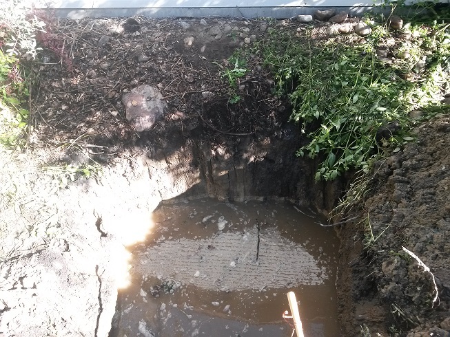

I started putting up an antenna tower in my backyard. Reason #1 for the tower is to get high-speed internet in my remote rural location for less than 200 dollars a month. From the ground I can see only one cell provider's tower (the expensive option). At 45 feet up, I should get a signal from a lower-cost provider with unlimited bandwidth for 1/4 the cost.
The tower is a self-supporting steel truss, 40 feet tall with a 6 foot extension tube on top. The manufacturer of the tower provides an installation sheet for the do-it-yourselfers like me. The minimum required base is about 5' x 5' x 4'deep. For those who want to see more tower details, a google search of "DMXHD-40N" will give multiple hits from the OEM and various distributors of the tower.
Things started to go wrong on the day I excavated the hole. The actual excavation went smoothly (mini-excavator from Home Depot did the job in 1.5 hours). But it was pouring rain the whole time. Following that downpour came another heavy rain that added up to about 60 mm of rain. This is very unusual for Calgary, by the way. Just my luck. The pit filled with 2 feet of water, receiving not only the direct rainfall but also run-off from the garage roof which I didn't think of diverting. I sump-pumped it to 6 inches and allowed another week for it to dry out.

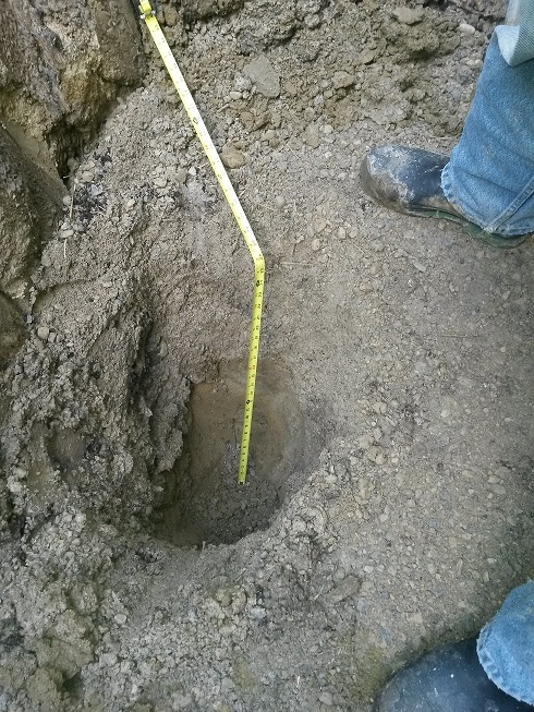

This weekend I tried putting in the gravel base, but I was dismayed to find that the gravel never became firm. It just adopted the texture of mud. By hand, I dug down to see what was underneath. The gravel/mud mix was about 6" deep, below that was like clay, and below that seemed to be sand. Then why did it take a week to drain the last few inches of the water? I'm thinking the sand is so fine, and mixed with clay, that it can't drain quickly. Even though it looks and feels like sand. Pressed between my fingers the deepest sand is granular, and does not smear mud on my fingertips. Why didn't it drain water from above? I do not know where the water table is, but this hole at the bottom of the excavation added up to 6 feet below grade and it did not fill with water.
Another thing that happened while packing the gravel, where it would pack, is that it seems to "float". This is hard to describe - it's like I'm standing on a waterbed and when I push my foot down, some other spot pushes up. This is hardly a solid footing for a 10,000 pound concrete block!
Is there a way to improve this gravel base?
What are the odds that by excavating the hole deeper I will find more solid footing?
Should I abandon the hole entirely and locate the tower elsewhere?
This isn't my first tower base excavation, but this is the first time I've had difficulty with water - and exposes how little I know about civil engineering. sad
If I look for a professional to help on site, what should I look for? Architects with foundation wall / retaining wall experience? Excavation contractors? Most of the options I find seem like turn-key project managers who won't be interested in a small project that's already half-finished ("half-botched?"). I'm willing to pay a pro to set me back on the right course, but I fear that none will want to "own" the result of their advice.

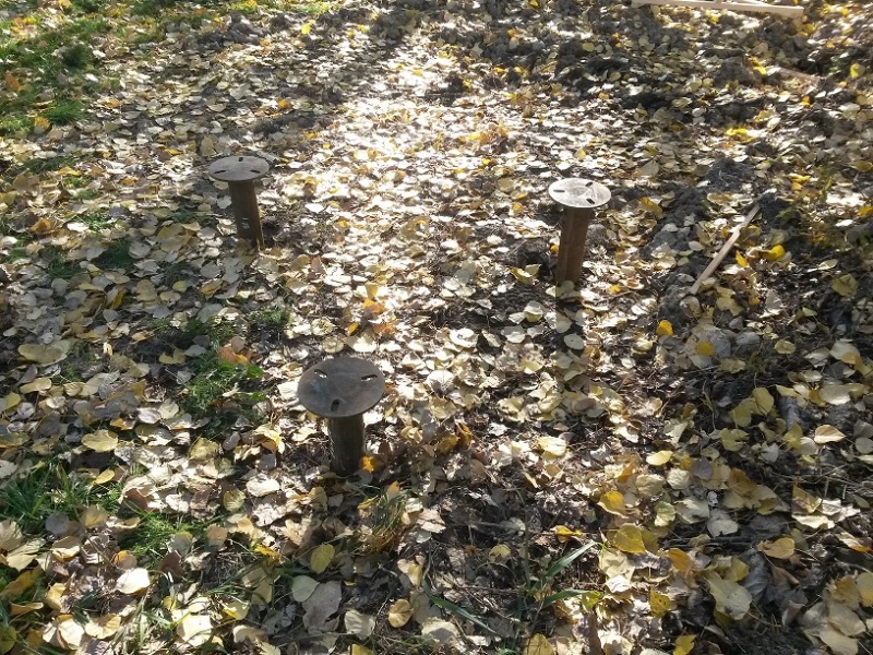

Done!
Found a contractor willing and able to install screw-pile anchors, and as I was on the phone with their office, the engineer checked my numbers for me, and made some recommendations to get the torque right. Finally, I can get back to welding up the interface to the tower - the project is fun again.

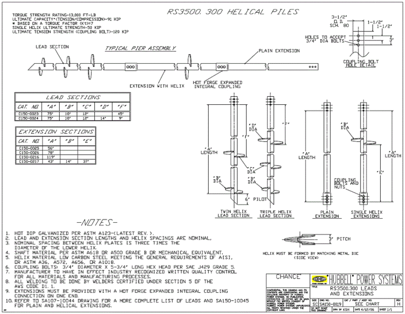

Muck hole is 10 feet away. This is undisturbed ground. The piles I used are 9-1/2" feet long, the helix is about 8 feet down.
Screw-piles are like the graphic below, but mine didn't need multiple helices. In the photo, all you can see is the cap that slid over the top - so yeah, it's not painted.
I have read a LOT about how torque is not a perfect indication of the ultimate strength of such piles. However, perfect is the opposite of good enough. The engineer talking to me about the installation was working with a safety factor of two, and I didn't mention that my tower leg loads also have a safety factor of about two. My calculations also ignored the effect of the interface frame that I am building to mate the tower legs (30 inch spacing) to the anchors (48 inch spacing).

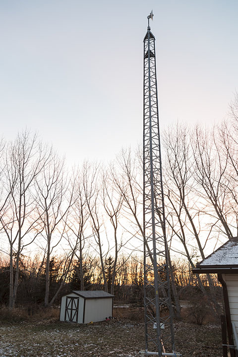

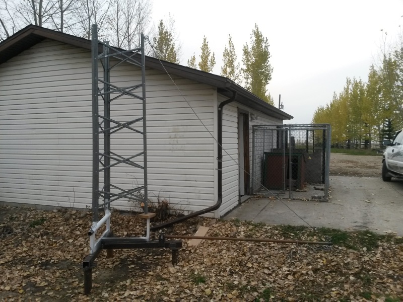

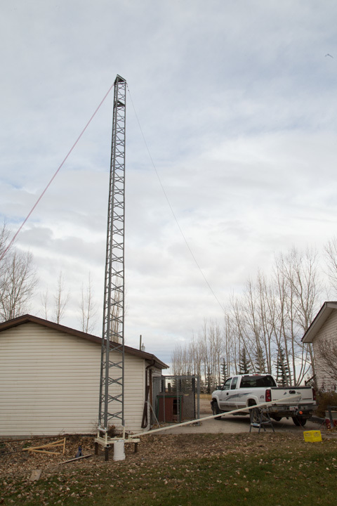

The happy ending to the story:
Antenna dish at the top of the tower, at sunset yesterday. The guys came to install their dish and test the set-up, while I operated the tilt-up of the tower (people don't like to climb towers any more, gosh). The fellow was getting a -74dB signal when he tested the strength with his own laptop. Sounds good to me... what does that really mean? Is there an absolute value over which the ratio is divided, or is it a ratio between background noise vs. signal?

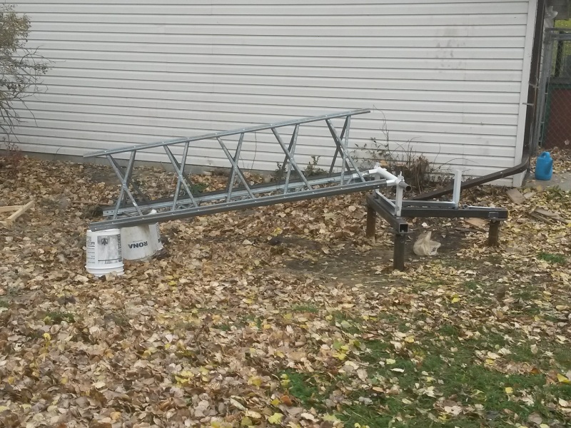

The fun part was, for me, making a safe and simple tilt-up system for the tower. It was very convenient to use when the installers were here, and they appreciated the ability to attach their antenna and run the cable, with the tower at ground level. Tilt-up took about 20 minutes. I had already buried conduit from tower to the house, so we just had to pull their Cat-5 cable through the conduit and finish the hook-up with connectors and their little black box.
Testing the tilt-up:
I tested it at first with just the lowest section of the tower, light enough to move just by hand with a single cable and gin pole. Everything moved freely, and didn't need much shimming to make it plumb. Then I located and drilled the attaching bar for the 3rd leg. This is where I also tested the "feel" of the stop when the 3rd leg comes into position. See, if there's nothing stopping the tower from going all the way over, then the 3rd leg doesn't stop the tower from flipping all the way over and crashing down. The wood block seen between the 3rd leg and the base stub was too hard, and as the tower came up vertical, it banged down on the block hard enough to impress a groove in the wood. Imagine what the whole tower would do with a stop like that. So stopping the tower gently, before the 3rd leg came up short was critical. I settled for a "back-haul" rope, though it's a little fussy to set up and tie off at the right spot. You can see the back-haul rope as the red rope in the photo below, on the left.
The rest of the system: A winch, attached to the trailer hitch of the truck, and a 20-foot long gin pole, to direct the pull from the truck into a pull at the top of the tower, with cables.
The bottom line: The tower, winch and materials cost a bit more than 1000 dollars, the installation of the screw piles another 1000 dollars, and other stuff in the system like hardware, buried conduit, steel cables, and a new bottle of MIG shielding gas added another few hundred bucks. The benefit is that today I'm posting on an unlimited-bandwidth high-speed internet connection which costs me 60$ per month, and I have turned off my cellular-net wireless internet receiver, which cost me 250$ per month for 30 GB. The pay-back time will be less than 2 years. I'm also cancelling satellite TV and getting a UHF antenna, which will save another 50 bucks a month. My 14-year old son has been watching youtube videos for the last hour - something he hasn't been allowed to do from home before.

How the heck did you point the dish accurately without someone up the tower to gain-it-up?
Have you done anything to keep the lightning out of the house?
Thanks for the great pics too.
Keith Cress
RE: Stuck in a hole, still digging
Never thought of taking a picture of it, but I put an antenna rotator motor on the top stub. The kind folks used to use to point their TV antennas. It even says "Radio Shack" and "Archer" on it. Like, 1980's or something. A neighbour of mine had one when I was a kid (my folks got an antenna with good enough omni directional reception not to need to rotate). Anyway it still works, and it came with the tower when the guy sold it to me (he was moving and setting up his HAM stuff elsewhere).
It turns out that the guy that came to the house knew roughly the right direction to point it (10 degrees west of north) and he got it first try. I didn't actually use the motor. Shucks.
Gain was displayed by a program on the guy's laptop computer. There was some interaction with the transmitter station, but the response was almost immediate after he plugged in the Cat-5 cable. I didn't ask a lot of questions to which I wouldn't understand the answers.
There's an 8-foot deep ground rod in the earth beside the tower. There's no urgency to ensuring complete isolation, but you're right. Before summer comes, I have to find out if the "point of entry" device that connects to their CAT-5 from the tower can also suppress surges before sending them to the router. If lightning gets into the router then the surge could fry my computer or my weather station display panel (both of which are wired in).
