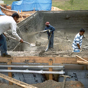

Typical construction for a residential pool consists of PVC pipes embedded in gunite.
It is also common for PVC conduit to be in the concrete:

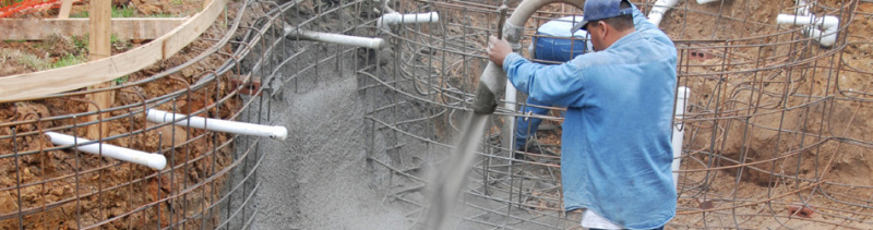

EdStainless, the pictures above don't show it, but how do expect the bottom drain pipe to leave the pool.
Anyway, here are some better pictures showing PVC pipes going through the gunite into the earth.
