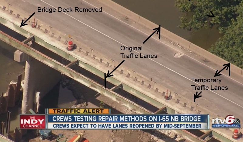

1. One thing my father taught me: Do your foundation (substructure) work first, at least until it is above ground / water. On this widening job, the Contractor appears to have detoured traffic, removed necessary parapets and bridge deck, roughened the surface of existing piers... then started work on the footings.

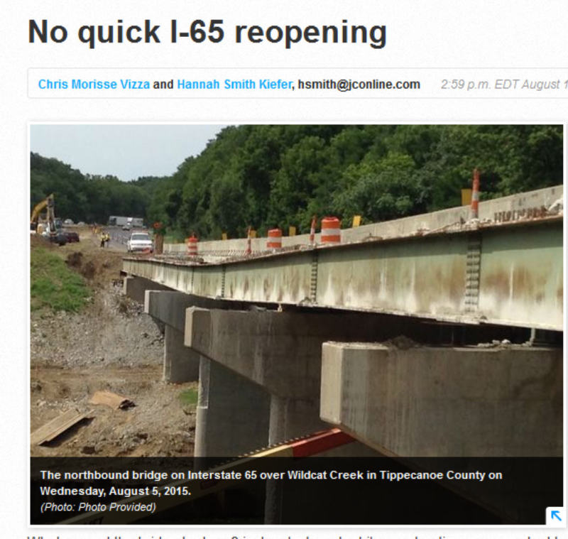

2. The bridge had settlement problems, but notice in the following photo that the traffic detour and parapet / deck removal are putting eccentric loading on the existing footings:

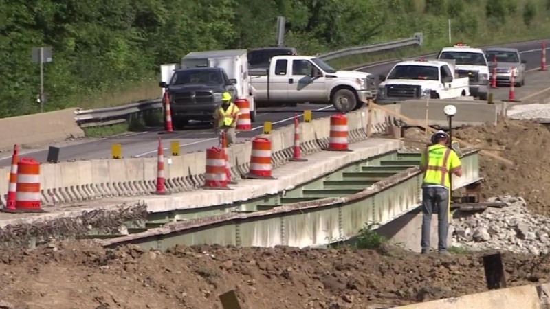

3. The eccentric loading is in the opposite direction than the "lean"... or is it? At least one girder is "off its rocker" (IMHO, Contractor too). Is the entire pier settling with the "lean" caused by a combination of pier settlement and the missing rocker? In the following photo notice that much of the deck, not just the edge appears to have settled:
As usual, there is likely much more to this story and much of my speculation will be flat wrong. I do believe the bottom line is that this problem will not be "fixed" by mid-September. I'll come back here and "eat crow" if it is.bat

SRE...I don't see any crow in your future! I agree.
Further, the pier is incredibly thin in the direction of traffic. Odd.
