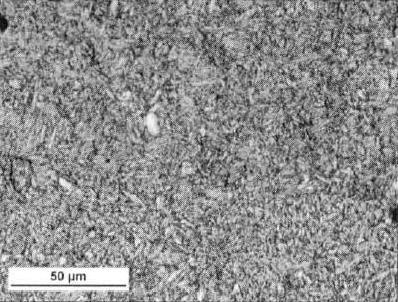

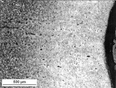

The gears were checked with two different Rockwell Hardness Testers and the result was always around 68 HRc. Then the gears were sent out to a laboratory for a material analyzis. They have reported a microhardness HV 0.8N (80G) at distance from the surface .05-2.0 mm as follows:
The chemical composition:
The surface layer structure:
The surface layer:
Based on these results they have indentified the material as 17CrNiMo6 after carbourizing. A 1 mm thickness of the layer with minimal hardness of 550HV has been reported. They stated, that the maximum hardness of 940 uHV equals to approx. 68 HRc.
Any clues on how is that possible?

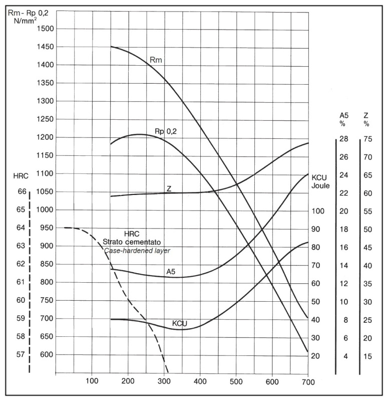

Looking at the tempering curves for 17NiCrMo6 below; it appears that the max un-tempered hardness is around 64HRC. I've no idea how 68HRC (equivalent) could be achieved.

The hardness profile of the carburized case you posted shows a hardness of around Rc66 at a depth of .020", which seems unusual. The core hardness of around Rc35 at .080" seems about right, but I would expect the case hardness at .020" to drop more than just 2 points (68 to 66).
You might want to take a look at AGMA 2004-B89. It provides guidance on preparation of test specimens for checking the hardness profile of carburized gear teeth. You should pay particular attention to the length and diameter (L/D ratio) of the specimen required for the size of gear tooth you have, as well as making sure when cutting and polishing the specimen so that it is not overheated. Both of these factors can affect the accuracy of your hardness testing.

Well, this is an interesting example for reverse engineering. In order to achieve hardness in excess of 64-66 HRC, you have to do something different than conventional atmosphere carburizing (gas carburizing) or low-pressure carburizing (vacuum carburizing). Adding ammonia to the gas mixture during atmosphere carburizing is called carbonitriding, and can lead to increased hardness after quenching and tempering. Personally, I have never seen 68 HRC for this process, or even reported in technical literature, more like 65-66 HRC as a maximum. There are some treatments like ion nitriding that can create very high surface hardness, but usually the depth is quite small, not > 0.5 mm to 800 HV. If you are really interested in understanding what is going on with the sample, you will need some further testing that is quite specialized like elemental mapping of the near surface layer (SEM w/ EDS, maybe Auger analysis) and X-ray Diffraction.
