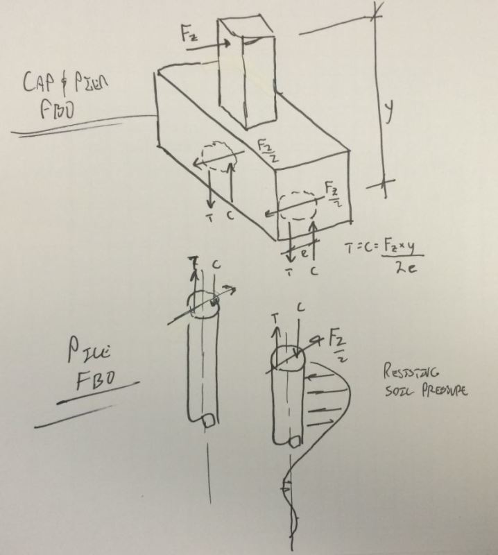

I have a pile cap with two piles.The Fz in the pedestal causes torsion in the pile cap. If the concrete in pile cap has enough capacity to take torsion, torsion reinforcement is not required. But the torsion in the pile cap should be transferred to the pile.
Can anybody explain me weather i am right or wrong. Kindly explain me in detail the force transfer from pile cap to pile for force Fz.

The force Fz will cause bending Mx in the piles that needs to be designed for. Any torsion My in the piles would be only a "compatibility" torsion and can therefore be ignored (provided you are not relying on it to reduce the bending moment My in the pile cap).

Convert the torsion (Mtorque) into horizontal force, then apply to the pile. If you already have a Hforce acting on the pile, add this up to that.

Retrograde's answer is correct. The torsion in the pile cap becomes a bending moment to be resisted by the two piles. Or you can just take Fz/2 to each pile, which gives you a shear and a bending moment.

Assume "y" to be the vertical distance from the top of pile to force Fz. Each pile will experience the following due to Fz alone:
1) V = Fz / 2
2) M = Fz x y / 2
From there, each pile will need to transfer force in a manner very similar to what we've discussed in past threads where we were talking about single pile systems.

A sketch of the the load path is shown below. I asked a related question recently regarding the detailing at the cap/pile connection: Link. You may find that relevant to your problem.
