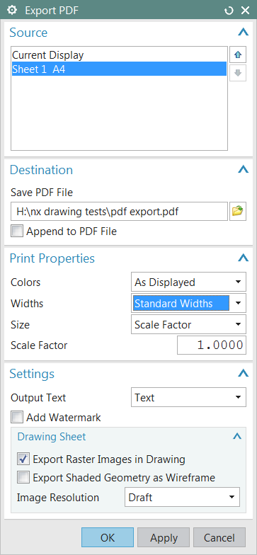

RE: NX drawing pdf export
OK
NX version: 10
Font: "Arial" (no matter what font i use, the result is same)
output text: text
is any other setting to be changed?

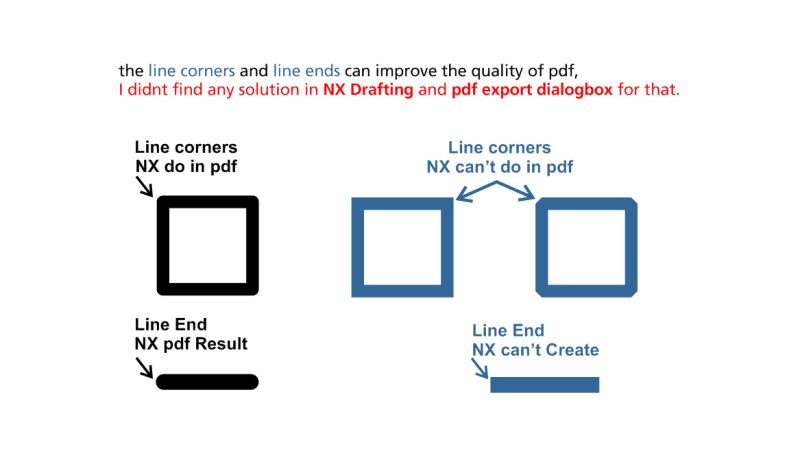

it will be great if next version fix this problem and here is another problem with lines.

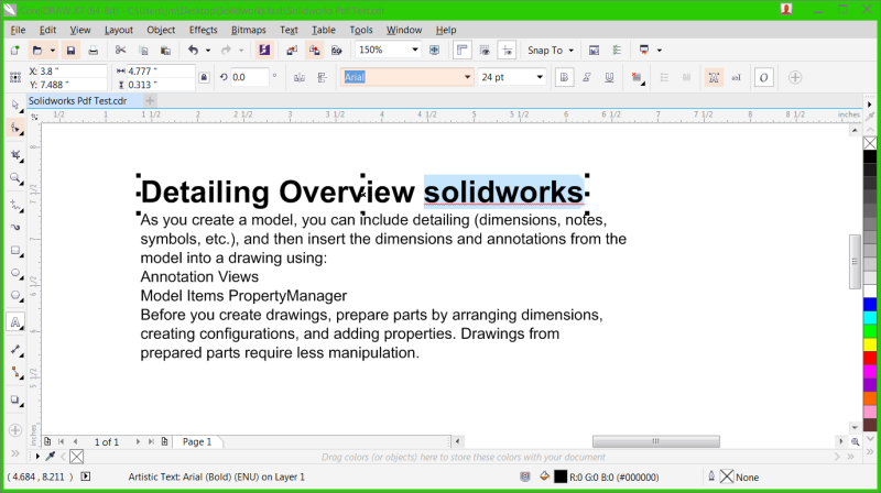

Thanks john
but graphical softwares like coreldraw or adobe illustrator can save text data as pdf.
then it will be possible to open pdf again and edit text fields like their native vector formats.
also solidworks exported pdf can be edit in these softwares.
i attached a quick screen capture that shows the edition.
this is an image of solidworks pdf after opening in coreldraw
the text recognized simply and can be edited.

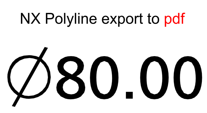

this question pop in mind, if there is no difference between polyline and text what is the reason for existing this choice and dialog box in pdf export command?
please consider another screen capture i attached that shows geometry can be exactly like text and not be jagged.
The main difference between using the 'Text' versus the 'Polyline' option is that if you use the 'Text' option, the text on the resulting PDF document can be searched using the 'Find' function, whereas this is NOT the case when using the 'Polyline' option. As for the final 'quality' of 'text' elements, there is no real difference.
Try this,
Windows Control Panel -> System -> Advanced System Settings (Upper left) -> Environment Variables
Create a variable (user or system)
Variable name: UGII_PDF_NO_HIDDEN_TEXT
Variable Value: 1
As long as you have the PDF export setting for text on, the PDF will have text rather than the CGM overlay as mentioned above.
If you edit the exported PDF you can change the text.
Anthony Galante
Senior Support Engineer
NX3 to NX10 with almost every MR (21versions)
hello Anthony
Thanks a lot.
it works very well
you are great
