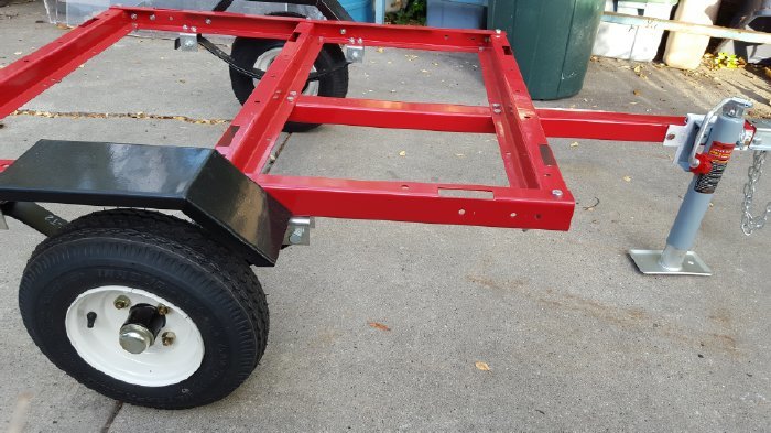

The plan is to build it onto a small trailer, your classic Harbor Freight $200 type. Sort of like the one in the picture except with much shorter wheels. I have the trailer! It's waiting for me to assemble it. However, I think I might want to make it narrower than stock to make it more manageable around the homestead.

Mount exactly a shown in the picture. No floor. Put a catch tray full of cat litter under it when in operation to catch the inevitable drips of oil and offer a small degree of sound attenuation.

Failing that, the tires are nice isolation but you need the same at the jockey wheel.
In order to isolate effectively you'll need bigger softer bushings than those shown.

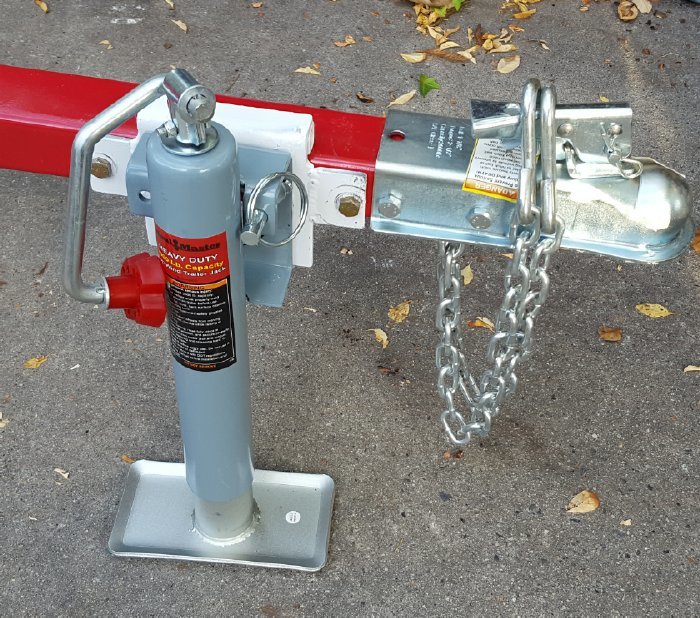

First thing I noticed?
Dang, no trailer jack, so it, of course, lays there looking all.. slanted. Back to the drawing board. I looked around and ended up coming back to HF again for their smallest simplest jack. It was $25.

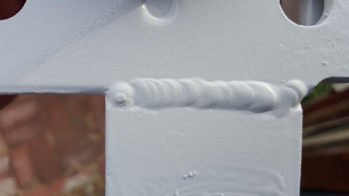

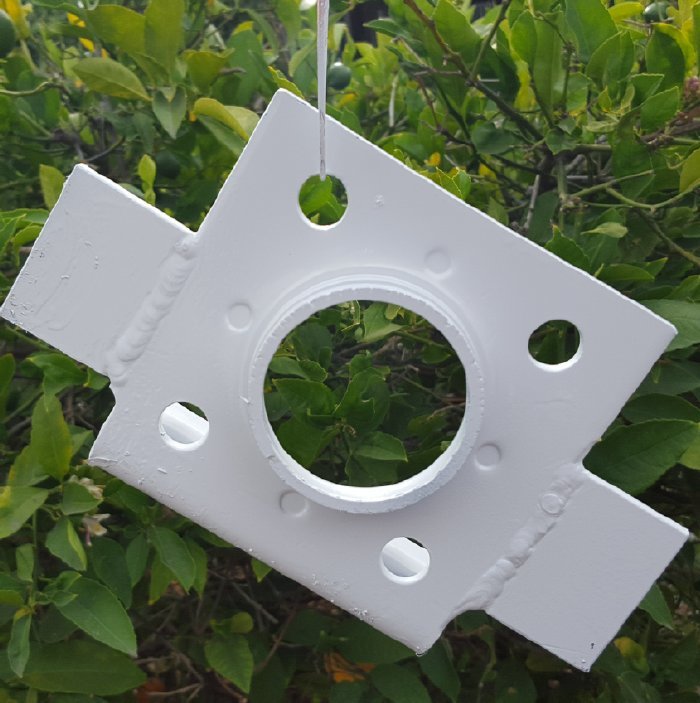

There was a catch though. It has to be welded on! The clamp-on ones were $40 and rated at a bazzillion pounds. This one is only rated for 2,000# which is only about 1,900 more than I need. I didn't want to blitz my new trailer by grinding all the paint off the tongue so I decided to modify the jack mount so it could be bolted on. After wrestling off a monster clip ring I got the back half of the jack mount off and then TIG welded two tabs onto the mount.

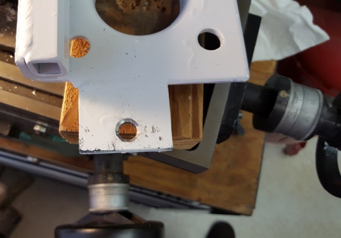

My first weld in about two years. I wasn't enjoying myself before because my eyes are not so great close up anymore. (I used to be able to see protozoa with my naked eyes.) (Those were the days) But, this time I put on my reading glasses inside my helmet. WOW! Fun again.
I then cast about for some paint to prevent rust. After finding the usual 6 cans - none with working nozzles - I swear I always invert the cans and "clean" them too. At any rate all I had was a can of white with a non-removable nozzle. Turning that can over never provides a clear stream as the pickup must be a weighted hose. I sure waste a lot trying to clear it, but it never clogs. Go figure.
So I paint it. I take a piece of TIG rod and thread it thru to hold the work piece. I spray it nice and white.:
Then because I'm holding the rod in my glove I can't feel the F=ma worth a dang and the rod slowly slides thru my gloved hand while I'm not looking until the finished, just painted piece falls into a weedy dirt strip next to my shed. ARGH!!! I'm glad no one was in earshot. I snatched it up and wiped the dirt, leaves, and grass off with my dirty gloves and lathered on more paint.
Then I drill the tabs out for some 3/8" bolts.
I then drilled and mounted it to the trailer, slid on the jack and my son and I did battle with the muther-of-all-clip-rings and got it back on.
Ta da:
Works great! The rotating jack half doesn't even collide with the bolt heads!! What a treat.
So now the level trailer:
Keith Cress
RE: Please join me in building a poor-man's quiet generator
You've been busy!
Does that frame need a diagonal brace? Looks like it would turn into a parallelogram given a moderate force.
Hi Scotty;
It seems pretty stiff at this point. Note the pieces are all sporting multiple bends making them individually pretty dang stiff. After adding some thick plywood it will probably get stiffer yet. All the bots are impact tightened.
I'm about to do that but need to check a few things as the CG needs to be reasonable so the tongue weight stays around 100 lbs.
