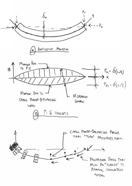

Here's some related info supporting the notion that second order balancing load effects are what keep prestressed axial members from buckling under their own prestress.

I totally agreed what you have posted Kootk for column only. However, I am still not sure how to make the concrete to behave non-linearly in Strand7.
RE: Strand7 and eccentric prestressed slab
A post-tensioned slab on ground differs from a column. The ground imparts a tensile force on the slab, which is at the bottom, and thus eccentric.

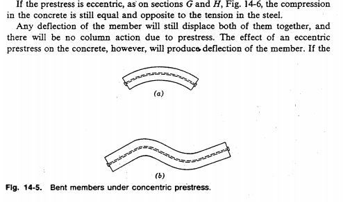

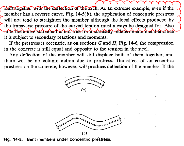

@KootK,
We still have an outstanding issue to be addressed in this thread. Concentric post-tensioning tendons in a curved prismatic member produce pure axial compression throughout the curved member. They produce axial shortening but no deflection.
When a slab is tensioned concentrically and then curved by external forces, the effect of the prestress remains the same. It is still concentric no matter what shape the slab takes. It can produce only pure axial stress in any section normal to the curved axis. Deflection produced by external forces does not result in any load balancing by the tendons.
BA

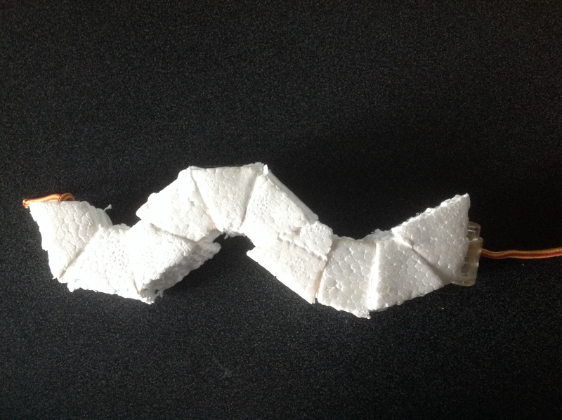

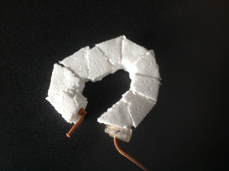

What BAretired is stating (curved beam with concentric presterss = only axial compression) was what a professor friend of mine (Dr. M. Tadros - U of Nebraska Omaha) some years ago.

I tracked down that TY Lin stuff. Unfortunately:
1) Like the Bazant info that I posted above, it speaks to the "column effect" rather than balancing loads although the topics are surely related.
2) It doesn't have anything to say explicitly about the the presence or absence of a load balancing effect due to the tendency of the tensions wanting to straighten etc.
I submit the sketch below for group review. It illustrates the mechanisms that I mentioned in my previous post.

My copy of "Prestressed Concrete Structures" by T.Y. Lin, Copyright 1955, Fourth Printing 1959 is probably older than the reference mentioned above. Fig. 12-3-5 in my copy is identical to Fig. 14-5 in the one cited above.
In the discussion on the next page, Lin stated "As an extreme example, even if the member has a reverse curve, Fig. 12-3-5 (b), the application of concentric prestress will not tend to straighten the member."
BA

Quote (BAretired)
I wasn't able to find this but I'd very much like to check it out. Can you tell me the title of the section that it's in BA?
Certainly, KootK. It is in Chapter 12 "Tension and Compression Members". It is Article 12-3 "Column Action due to Prestress", pages 353 and 354. If you wish, I could scan it for you.
BA

KootK,
Paragraph directly above that you pasted...
Ref: "DESIGN OF PRESTRESSED CONCRETE STRUCTURES" LIN/BURNS, 3 Edition, 1981.
Quote (BA)
Gracious of you to offer BA.
Quote (Ingenuity)
Well, don't I feel foolish. Further evidence that middle management is rotting my brain. Of particular interest is the statement about this not being applicable in continuous structures because of secondary effects. I was having a hard time trying to think through the same logic for a multi span member.

Sometimes simple (and crude) physical models assist in the understanding:
Quote (Ingenuity)
Thanks mate. I have done similar model and it works.
