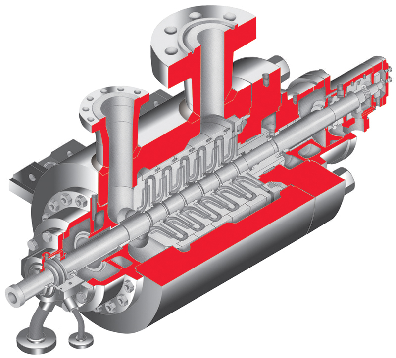

RE: Straight run at suction of pumps
DubMac, this is a BB5 pump from Flowserve:
bmir, do you mean BB5 needs 5*OD straight run at suction?

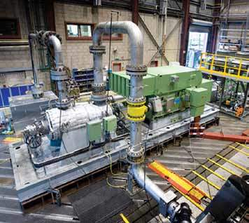

When referring to pipe diameter, the common nomenclature for pipe size is the pipe ID. My opinion is that the API recommendation is 5 (ID) pipe diameters of straight pipe as quoted above. Of course, this is the minimum.
The brochure from Flowserve for the BB5 has a few pictures showing the piping.
