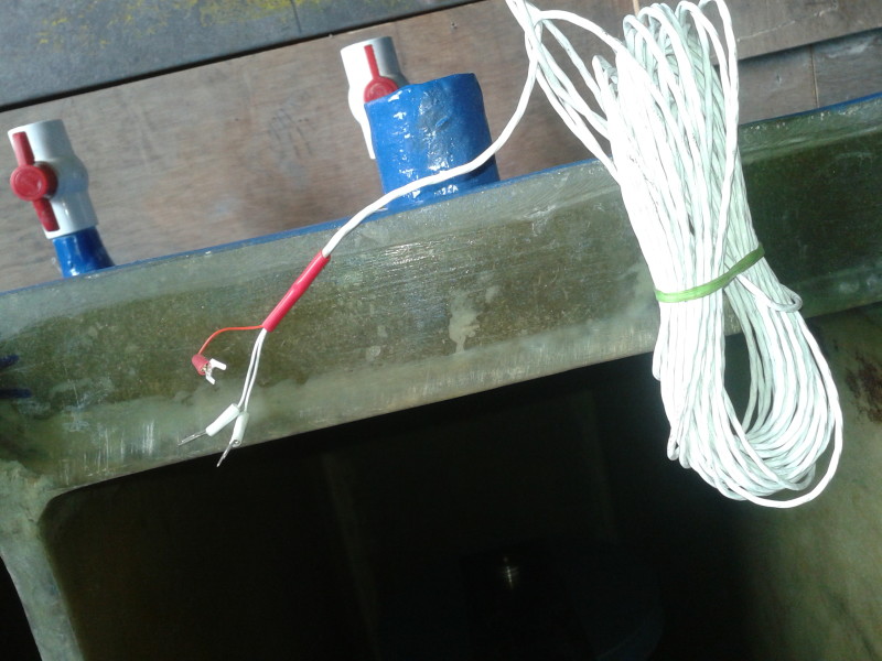

I have to install a new temperature controller to a new tank that has to be heated with a electric resistance
The temp sensor has 3 cables: 2 white, 1 red
The seller of the tank is not responding
At first I thought that the sensor was a thermocouple but I am not sure because TC usually have only 2 cables
Any help on identifying what type of sensor do I have? Is it a RTD?

Yes, it looks like a 3-wire RTD. Check the resistance between the wires, one pair should be a near short circuit. But that may or may not help you much, as you also need to know the material (platinum, nickel/chrome, ...?) to know the temperature coefficient.

R white_red=113,5 ohm
R white_white=2,5 ohm
I am guessing is a Pt100
RE: Temperature Sensor Type
It's probably a Pt100, since Ni tends to have a 120 Ω base resistance. However, as btrueblood pointed out, you still don't know if it's a Pt100-385 or a Pt100-392.

I concur with the 3-wire 100 Pt.
The whites are common, tied together at the RTD. You will need a 3-wire RTD controller. A symbol on the controller usually shows the schematical hookup clearly.
Then choose one of the two standards (US or European) and using an accurate thermometer at two different tank temps see if your guess was right.

Odd wire colors, though. The standards for industrial platinum resistance thermometers (ASTM, IEC) indicate 3-wire color code is supposed to be red, red, white.

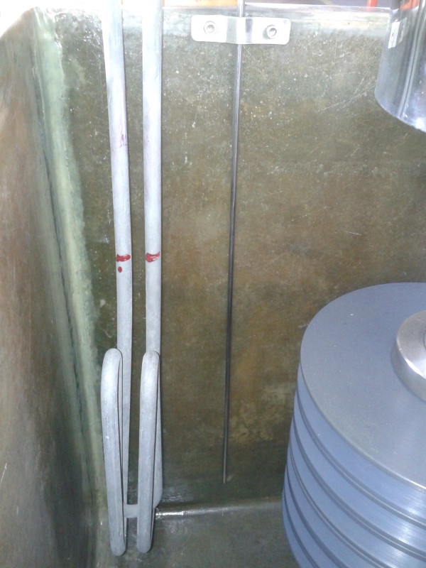

Odd colours possibly because it appears to be Teflon-coated wire. The unit is immersed in an FRP tank and that looks like a PFA-coated heater element in the picture too- a plating bath or something else containing corrosive material.
As moltenmetal said; Tank is FRP and heaters are PFA-coated.
Tank will be filled with H2SO4 (20% in water)
Process temp will be 75 ºC
Already bought the controllers with Pt100 / Cu50 / TC sensor input
