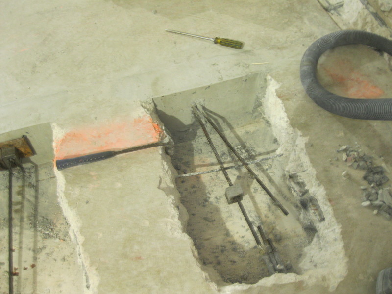

I thought about it some more, and I am wondering if it is even possible to perform a lift-off test in the middle of a stressed strand. See sketch.
I am thinking that they would have needed to first seat the anchor with the ram, cut the tendon to engage the wedge and leave a tail that can accommodate the ram stroke length, THEN perform the lift-off test.
Thoughts?

RE: PT Repair Book
Photos for your enjoyment....
"It is imperative Cunth doesn't get his hands on those codes."
RE: PT Repair Book
Quote (MacGruber22)
Exactly.
After installing a trouble-shooting anchor and wedges and seating the anchor with the ram, if they tried to conduct a lift-off test WITHOUT severing the strand between the new trouble-shooting anchors it would internally stress the ram to full pressure, but it would be trying to compress the strand behind the new anchors and since there will be no displacement the wedges will not lift off.
Great photos!
Seems that you could now get them to conduct a true lift off test as the photos indicate stressing tails behind each trouble-shooting anchor. A few anchors seem to only have a few inches of tail - so if they need to be checked for lift off the contractor may have to use a stressing-tube and splice chuck (aka short-stressing equipment) with a ram.
Over the weekend I will write up a procedure/method for a Lift-off Test for monostrand tendons and post it here.
I did search my digital library and found a chapter of a text on PT repairs by Florian Barth that goes into some detail on field procedures that I will post over the weekend too - but it is a bit light on info when it comes to lift-off procedures.
RE: PT Repair Book
Thanks for confirming my assumptions, and the info you found!
