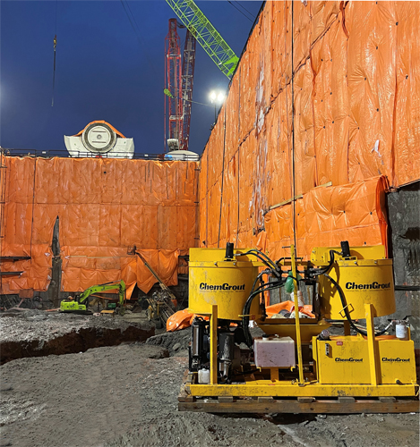

As LittleInch suggested, your best option is to use a hose instead of a pipe. One would not expect that the flow conditions may be successfully calculated without knowing the details and properties of the pumped fluid. Even with that information, there will be some parameters that will be developed empirically.
You may desire to contact Chemgrout, a company with experience in this field in a number of industries. They may be of assistance in sizing of the hoses as this is one of the products that they sell.
http://www.chemgrout.com/products-by-industry/heav...
