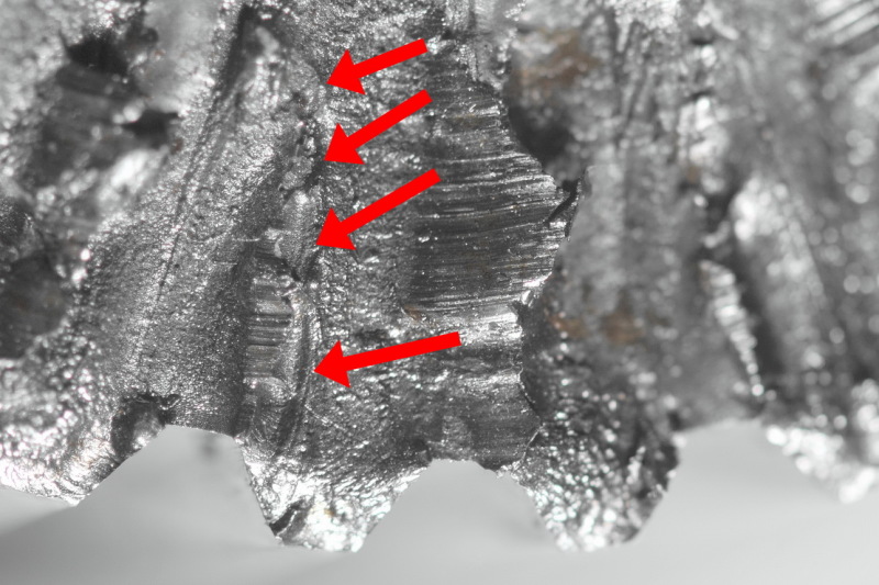

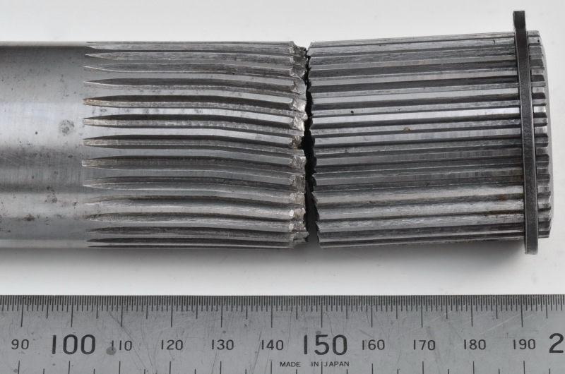

Here's an interesting failure of a small splined shaft that I'm currently investigating.
The Engineer's (hired by the OEM) final report simply stated that the incorrect material and heat treatment had been used.
The end-user has asked for a more detailed report along with recommendations.
There's a lot happening on that fracture surface.

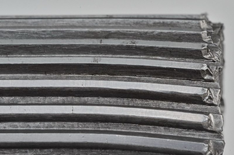

Definitely an unusual fracture for a splined shaft. Looks like a quick and clean break. Can't see any evidence of abuse on the tooth flanks adjacent to the fracture.
RE: Failed Splined Shaft, Interesting Fracture Zone

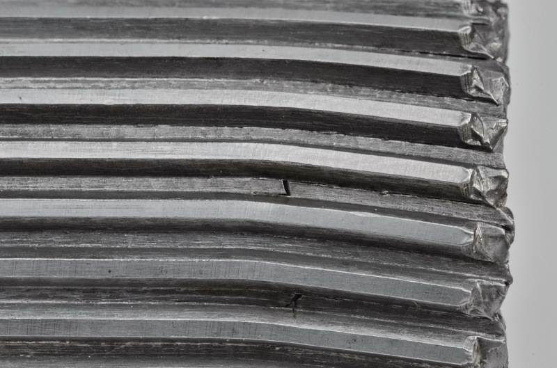

There's also no plastic deformation, the spline teeth run in a straight line along the length of the shaft.

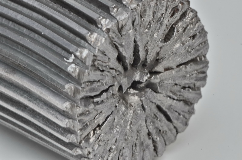

What I find really interesting are the radial cracks running inwards, starting at the top lands of the teeth, the last images shows this.
I would have expected those cracks to start in the corners of the root profiles.

Were the spline teeth case hardened by nitriding or a similar process? In the last photo it looks like there might be surface cracks propagating out from the tooth tips near the fracture face.
No case hardening, only through hardened - 32-35HRC.
Material is 4140.
There are multiple failure modes occurring. Quite a few areas are showing signs of fatigue.
Unfortunately the uploading of images here isn't working out too well as the image quality is being significantly reduced sad

I think it's a rotating bend failure with its multiple radial cracks but we could do with more information about the spline in terms of service loads and the length of time it's been in operation.

Reversed torsional fatigue, common for splined shafts in the automotive industry.

I would agree with mfgenggear's assessment. The root cause was more likely a fracture produced during heat treat that propagated quickly.
Given the shaft cross section, relative spline tooth size, material properties, and condition of the spline tooth flanks, I don't see how the shaft could have failed in torsional fatigue (from either unidirectional or fully reversing load cycles). Even a combined torsional/bending LCF failure at the location shown would have produced some distress in the adjacent spline tooth flank surfaces.
Which is why I asked about location of the loading.
Beachmarks in the last image suggest torsional fatigue originating at the outer edge.
If the crack at "A" (a low stress area) was produced during heat treatment (which I doubt), it may have reduced the torsional strength of the shaft, enabling the fatigue failure, but I don't think the failure progressed from there.

The client was finally able to supply the other half of the failed component.
The pictures is certainly becoming much clearer.
The groove on the LH side is as a result of events that occurred post failure.
Now I can see the location of the loading. All becomes clear. Thank you.
