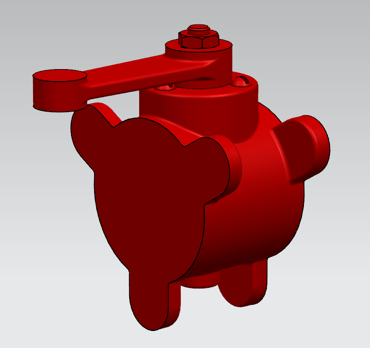

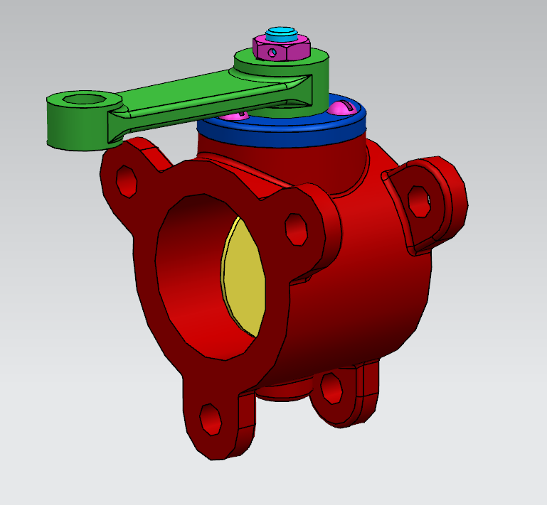

Yes, we have a function called 'Simplify Assembly' (use the Command Finder).
Here are before and after shots of a simple assembly that took only about a minute to process:
