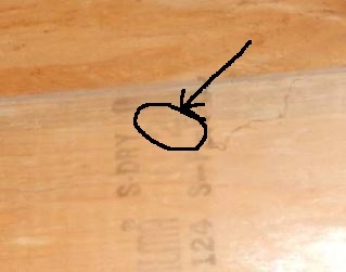

Trying to determine the capacity of some wood i-joist. I have attached a sketch and some photos. The cross-section does not match any wood i-joists from any manufacturer's catalogs. Ultimately trying to post a sign that will indicate the maximum live load. Any ideas? I've never seen 2x4's fastened at the bottom and top chords as can be seen in the photos.

Is there any grade/species stamp on the 2x4's? Any stamp on the plywood web?
For these to work the nailing between the two top 2x4's to the top of the plywood web (and to each other) would have to be done to develop the horizontal shear between the 2x4's and the web.
I can't recall ever seeing any manufacturer's products that look like that - so my guess at this point would be home-grown I-joists.

There are some grade stamps, manuf’g. stamps, on both the web plywd. and the 2x4 flgs. in the photos, but I can’t read them. Maybe a further inspection would be in order to try to pin the material grades down. There might be different grades btwn. the t&b 2x4 flg. material, with the better grade being in the bottom flg. When was this structure built? That would help pin down the allowable design stresses for a given grade. The photos certainly don’t show many (any) screws or nails that I can see, maybe a couple, nails btwn./through the flgs. and the webs, but no crimped nails. So you better determine what you can about the glue used btwn. the 2x4 flgs. and the webs, and how well those joints were clamped and made up. Any butt joints in the web plywd. had better be near the center of the beams/jsts., where the shear is fairly low. These will be weak points in the webs, but could be improved by applying vert. 2x blocking (or plywd.) on either side of the web, in the same vert. plane as the 2x4 flgs. There better not be any butt splices in the bottom 2x4 flg. pieces, and any in the top flgs. had better be very tightly fitted. These butt joints could be finger jointed and glued, but this is not likely in any home made, site built, jsts. You’ll have to rationalize some glue shear design values with wood design codes which don’t have much in the way of any design guidance or automatic approval of same. I agree with SRE, his suggested approach is the first step I’d take. As another first pass at an allowable cap’y., I’d take a look at a current I-jst. table for 14" or 16" deep jsts. on that span length; make some quick adjustments for allow wood design stresses; but also recognize that you have about twice the t&b flg. material and glue area as that provided by today’s tabulations and manuf’g. methods.

I didn't see any sign of glue at the joints - did anyone else see any?
Also - I think I see a big "2" on one of the 2x4's:
RE: Wood I-Joist
JAE - To my eyes, that is definitely a "2". There is another photo that shows a second grade mark with a "2". The grade stamp from the "Interior Lumber Manufacturers' Association", their web page shows that the "2" we see in consistent with Grade No. 2:
http://www.ilma.com/about/ilma-stamp/
I believe there is some glue visible in your photo, and on others. Look at the gray line at the joint of the 2x4 and plywood in your photo. Looks like these composite beams were carefully constructed.

looks like a too to me 2.
I am ass-u-ming glue, but, .. shrugs...
I'm not sure how they could be mechanically fastened without such fasteners being readily visible; and, if the one or to, too two 2 II visible fasteners are all that exist, well, then it seems to me the whole system is really being supported by just the top chord, and that's if they were top chord bearing, (which I don't know how they would do either....) Perhaps the visible fasteners were utilized to hold the system in place while glue hardened? But I agree that they look carefully constructed and I too would be reluctant to abandon them without further investigation.
