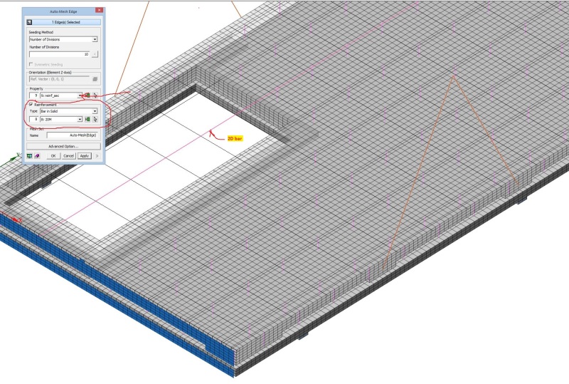

Anyone know how can I embed reinforcement in TNO iDiana using beam element?
They have a manual ConcMass but it gives only example of plane stress element with embedded reinforcement.
https://support.tnodiana.com/manuals/d944/ElmLib/n... I found this link but i didnt understand it. What command should I use?

Beam elements are trickier to use since both the bar mesh and the concrete mesh must have the same nodes. I have done this before for a variety of reasons. Why are you not using embedded rebar? Maz has a youtube video that shows that procedure.

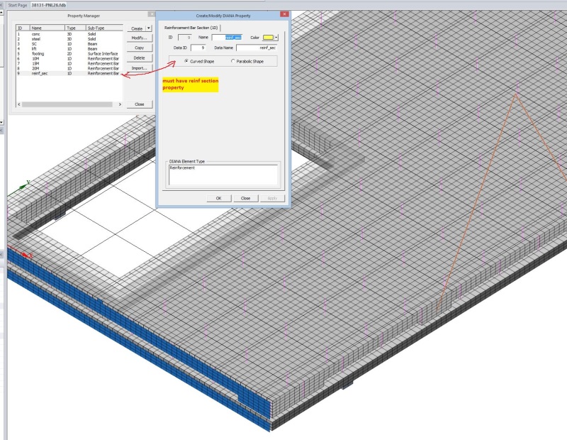

That video is blurred. I couldnt follow the video. Can you provide me the procedure of assigning reinforcement in solid or beam element. I have find the manual ConcMass and it has an example of embedded reinforcement in plane stress element. what do you mean by embedded rebar? In TNO iDiana I select reinforcement and reinforcement bonded. And for physical property I select embedded reinforcement bar.
Can you please tell me the procedure to put reinforcement in beam or solid element?

One can use beam elements to represent rebar, but then the nodes must align. We do this to represent non-circular composite fiber bars. Here it seems you are trying to model typical rebar. We use FXplus, so I cannot help that much with the iDiana code.

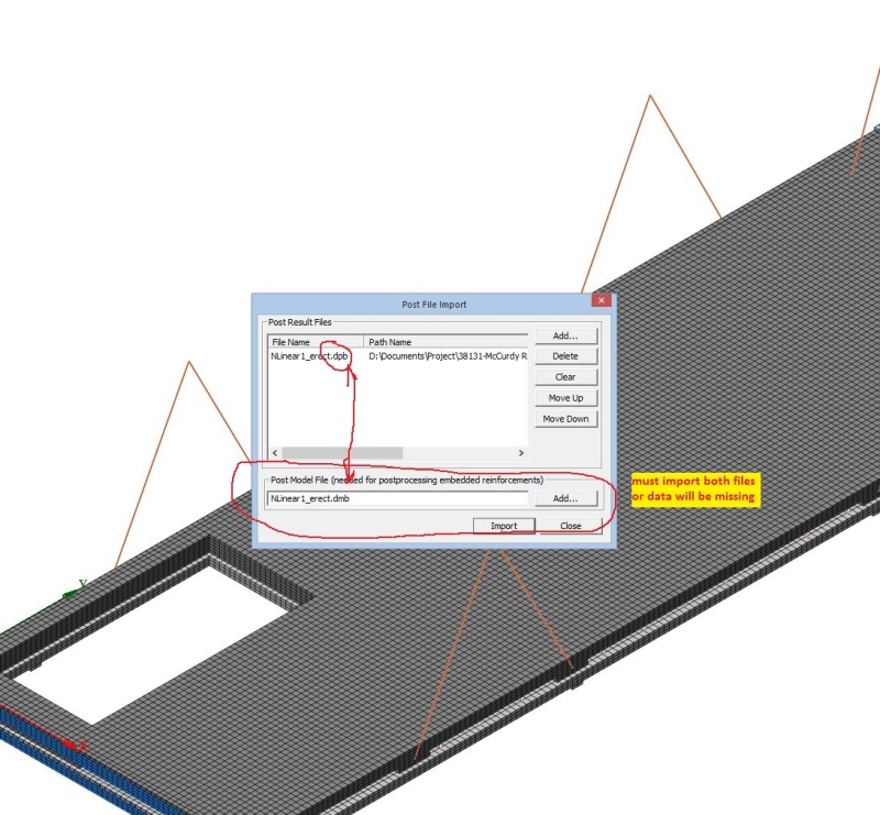

So now I have made beam using plane stress element in FX+, but after importing post neutral DPB file, Error occurs stating that element number 2402 is not found in the model. I have 2400 elements in the model. i don't know which element 2402 it is using. :(
Now I am making beam as solid with embedded reinforcement. I am following the video on YouTube.. but it is very unclear. I didnt follow what the user has done in Mesh Editor because I could not see what parameters it is taking. After running analysis on Diana. I import the post neutral DPB file the same error comes i.e element number 131 is not found in the model. :(

This is a silly question, but I assume you are importing both the concrete and rebar results after your analysis? You need to import a .dpb and .dmb file. I hope some of these steps are simplified in the next release due fairly soon. By the way, if you are a client of TNO Diana their help team is very good. They have created several tutorials for us.
Are you trying to model bondslip? If so, you will need to define the extra parameters as Maz shows in the video. If not, you can skip those steps. The DSTIFF value and profile parameters he edits in the mesh editor are only related to bondslip.

I was not importing the .dmb file which was causing the error. Also I am not considering the bondslip, so it means I dont have to follow what Maz has done in Mesh Editor.
