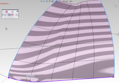

Can anyone suggest a strategy for getting good curvature bringing these curves together? Every time I add a hard constraint (such as a guide curve for a loft, or Direction 2 for a boundary), the surfaces become wrinkled.
The whole part is a just a rectilinear box with curved edges and a slightly curved top, and flat bottom, and this model is one corner of it.
The part will be injection molded.
I've put many hours into this, including training (instructor couldn't figure it out), tutorials, books, so I think I have to ask for help now.

I must be missing something because it looks pretty good when I open it. The only thing I do see is something kind of wonky on what I will call the top surface at the radius 90° corner.
RE: Strategy for multiple curves at corner
@djhurayt Thanks for looking at it. Yes, wonky. I betcha a bag of pretzels you can't get rid of it. Turn of curvature to see just how bad it is.

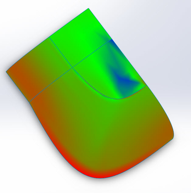

I got rid of that wonky area, but the curvature still shows some inconsistency on that edge
Scott Baugh, CSWP pc2
Gryphon Environmental
www.2gryphon.com

@SBaugh Thanks very much for the attempt. The sketch 'corner plan' on plane 'split' is a constraint. The curves must not go outside this line, and this constraint drives some of the trouble at the top flattish area.
Also, there is supposed to be a flattish area at 45 degrees around the corner which seems to be not present in your screenshot, as depicted in sketch 'corner top.' Imagine taking a flat file to the corner (which is what I did) and largely flattening the corner, then blending it with the file into the other two edges, which rounded, not flattened.

well that would make a difference then... didn't realize that was a Constraint. That Wonky area makes it tough to get a clean curvature.

@SBaugh Yup, that's the stuff I keep getting. Isn't this a common problem?
A little clarification just in case: the wonky area is a fill, the final portion left over after doing the main portions of the corner. It is not a constraint. The constraints are defined by the sketches 'cross top', 'long top', 'corner top', and 'corner plan.' It is acceptable to not follow 'corner plan' precisely, but the surfaces must not go outside the corner plan.
I have achieved an excellent top (the wonky area) by sweeping 'long top' along 'cross top' but then it becomes a hard constraint (after trimming it) for the main parts of the corner. This was the approach used in the iphone tutorial, but the iphone has only a simple corner (same profile all the way around the corner).

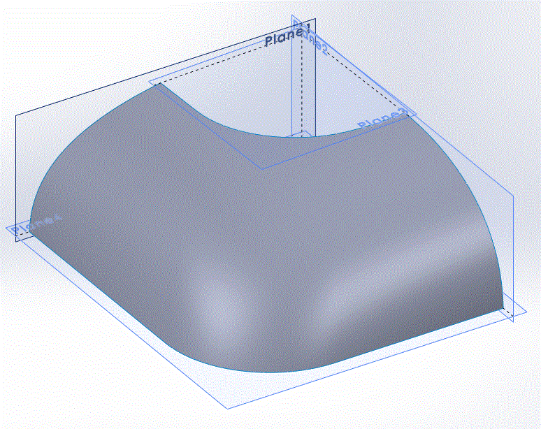

Yes, unfortunately for you we are on 15. But let me try to walk you through it. The basics are that I did mine with one lofted surface. I used you geometry to generate my curves and obviously had to make some assumptions.
  1. create Plane1, parallel to your Front Plane and through the point highlighted
  2. create Sketch1 on Plane1 using “convert edge” on your Surface-Loft2 profile
  3. create Plane 2, which is actually just a 0.0 distance offset of your Right Plane; only did this for continuity of the process and to keep the new stuff in one area
  4. create Sketch2 on Plane2, done same as Sketch 1 (see step 2)
  5. create Plane3 using the three highlighted points; assumption being that you want your surface to go through these three points only without the “wonk”
  6. create Sketch 3 with two lines from the end upper endpoints of Sketch1 & 2 and a tangent arc that is also coincident with the end of the line that is the intersection between your Surface-Loft1 & 2, this is also one of the same points used to create Plane3
  7. create Plane4, parallel to your Top Plane and through the point highlighted
  8. create Sketch4, using the same idea as Sketch3 (see step 6)
  9. create a Surface-Loft using Sketch1 & 2 as the profile curves, and Sketch3 & 4 as the guide curves
  10. wrap it up and put a bow on it

@djhurayt Thanks again. I've followed the steps, see pic below. You haven't shown your curvature; is it better?
The profile on the 45 degree plane is meant to flatten the corner. To get that effect, tangency controls are needed there. Loft only offers tangency controls on start and end profiles, so I also modified your steps to make two lofts, with a similar outcome.
A stellar effort, though, and much appreciated!
