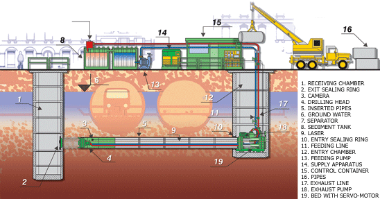

Hi all, I am doing research on the construction method of laying 900mm and 600mm pipe underground by segmental tunnel (maybe referred to hand dig tunnel) which is 2m x 2m x 30m tunnel at 6m depth (invert level). could you let me have your view on which main components should be considered when designing the tunnel? any reference could be made to? grade I rock stratum is encountered at the depth of 2m.

Forget hand digging. Focus your research on directional drilling and similar technologies.
RE: Segmental Tunnel
The space allowed for launching/receiving pits would have to substantially larger than 2.5m(w) x 2.4m(L) no matter what technique that you are using.
  • Directional drilling generally does not work in an urban area where it is desired to install the pipe level. You would have too much setback where the pipe enters the ground.
  • Pits as deep as 6 m would require substantial shoring.
  • The pipes are generally not installed in a tunnel.
  • The size of the pipe that you are talking about is also too small for use with a microtunneling machine.
One of the problems that you will encounter is how to make the connection for the service drop for each individual water user. You will have to install another pit to make the connection.
If you are really in the middle of a major city, you would be looking at some type of auger or jacking.

With your space constraints of 2.5 m by 2.4 m, the casing segments can only be about 1 m in length. The casing is almost as wide as the access pit. No room for shoring/bracing to keep the people at the bottom safe. could you post a plan view of the roadway with the utilities, etc. drawn in? I wonder if this can even be built the way you say you have to. Water pipes are normally 5-6 m long. DIP would be the same and 900 mm pipes will be heavy. you will need a major amount of space on the road for equipment. Cranes, pumps to run the rams for the jacking, trucks to deliver your 1 m pieces of casing and 2 m pieces of the pipe for the services and more I haven't even thought of yet.

However your pits are simply too small to be on any use, either to build the tunnel in the first place or insert any pipes in them afterwards. you need one to be at least 5-6m long. If you can't get this, then the technique is not feasible IMHO.

note that hand excavation is probably not possible for 600mm, 800 - 900 is generally the limit
a square tunnel is possible but probably not feasible, a round steel casing with a carrier pipe inside is a much better design.
main issues to address:
groundwater and dewatering if necessary
affect of water level or lowering of water level on stability of the face and pit walls
existing trenches / utility lines above the tunnel
leaking sewer lines above
allowable settlement so as to not affect everything above
rock, cobbles, boulders and sand or other layers crossed besides just the clay
shoring of jacking and receiving pits
length of jack / cohesion of material / calculation of the jacking force
determine the allowable length between jacking, intermediate stations and receiving pits
design of the foundation and thrust wall for the hydraulic jack
earth load on the pipe
jacking force on the pipe
design of thrust ring
need for mud or grout?
earth load on the jacking shield
what type of shield
slope stability at the face of excavation
removal of material, slurry pipeline, auger, buggies, buckets
curved or straight alignment, tolerance on line and grade
