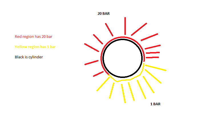

@Tuw thank you for the reply sir.
I will try with rubber and fine mesh.
But I have different pressure acting on cylinder.Upper surface has 20 bars and lower surface has 1 bar.I am giving this on each face of cylinder after meshing because if I select no filter than it selects whole cylinder.
So after fining the mesh it will have more faces and I need to give pressure on each and every face.So is there any way to give pressure like this so that I dont have to give on each face.
I hope you understand what I am trying to say.I have attached the figure for your ref.
Thank you for your valuable reply.
RE: NX NASTRAN Surface to Surface contact problem
Hi Harshitbhatt,
Simple. Divide the face accordingly during the CAD preparation step.
When trying to apply the loading condition, just apply at the polygon face (Choose polygon face at the selection filter).
@Tuw I am doing the same sir.
But when mesh is done fine,number of polygon faces also increases.
