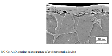

Ramkiyengar- Thanks for the reply. I'm not a specialist in metallurgy, but I am definitely interested in the subject. I did a bit of reading on the ESD process. The papers I read do use the term "alloying" to describe the ESD coating process, which I found a bit confusing. From chemistry class I recall an alloy is a solid solution or compound of elements where at least one is a metal.
Diffusion bonding is a solid state joining process where atoms of the contacting surfaces intermingle over time if subjected to the right combination of pressure, temperature, and atmosphere. However, the depth of the diffusion zone can be quite limited when dissimilar materials are being joined. While I believe the material within the diffusion zone can technically be described as an alloy, I also think there might be a better term that could be used.
I've done some work with friction welding, which is a solid state process. And one thing I recall looking at micro-sections taken from the welds is that it is very hard to see any grain boundary around the weld zone.
Below is a cross section of a carbon steel surface that was ESD coated with a dissimilar material. You can clearly see a well defined boundary between the coating and substrate. This is not what I would describe as "alloying", but that is the term the author uses. To me the interface looks more mechanical than metallurgical in nature, but I'm no expert.
Interesting discussion and I've learned a bit about ESD processes.
