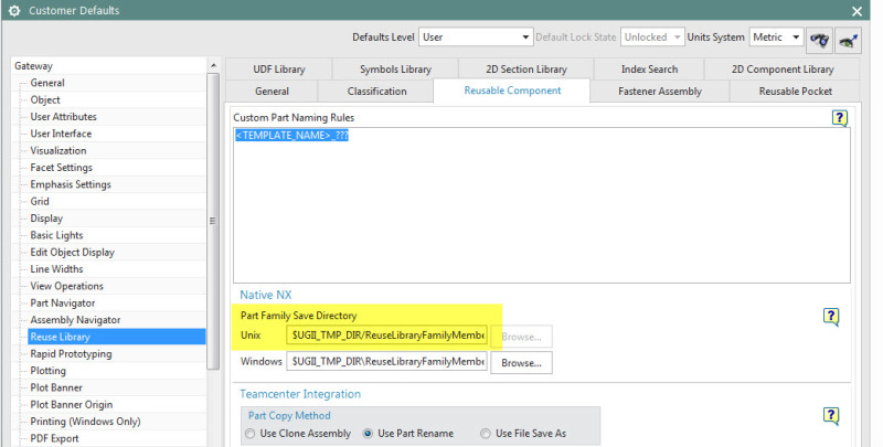

I've got another issue now. The library works fine for me. I installed it on a common network drive. Another user did the same thing and now they have the library available. But, when they load an assembly I made with some library fasteners, they don't show up in the browser. The place holders are there though. Any ideas why?

RE: Is there a Machinery Library available for NX10?
The problem will most likely be that when you added the parts to your assembly, they would be saved in the folder specified in customer defaults.
On my system, the OOTB setting is saved in a local folder (see image).
In your case, that means (unless you changed it), the folder you saved to is not available to the other user.
Specify a common folder accessible for all users in the customer defaults, that way in future it will work.
To fix what you've done, move the reusable parts to the common folder, change your load options to search folders and add that folder in the search.
Save the assembly and you can the use As Saved in future to load.
