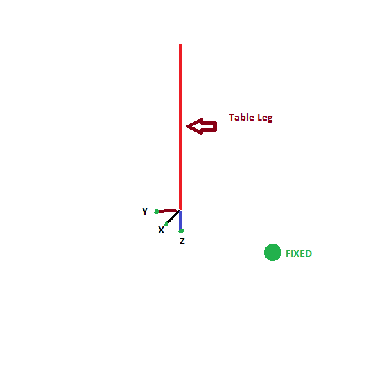

Hi RB1957,
I am not sure if this is an issue. Anyways, here it goes.
I tried a simple table subjected to a distributed load. The loads were applied to represent 9g forward emergency condition. I modelled the table leg attachments using the approach you suggested. Three CROD elements in each direction.
The unattached end of CROD element was constrained in all 6 DOFs.
When I extracted the constraint loads in each attachment using 'Loads->Freebody->constraint forces' option...I can get axial forces but no moments. Is it normal to have no moment reactions in the attachments?
I realize CROD element in NASTRAN can carry just axial & torsional loads.
I hope I have provided enough info for the question to be answered. Please feel free to ask if more info is needed.

Hi RB1957,
Thanks again for the response. I am getting a constraint force in 3 directions (X, Y, Z) in each attachment not 6.
As I mentioned in my previous post, the attachment is acting like a simply supported end fixity and thus no moments are being developed. (The bending stress is zero in the table leg towards the attachment end).
Here is how I have modeled the attachment. Would appreciate if you could please let me know if I have gone wrong somewhere in the interpretation.
RE: FAR Inertial Loads in MSC NASTRAN
words (and meaning) getting mixed up, pic looks fine !
each rod carries axial load, each fully constrained end of the rods has only one reaction.
