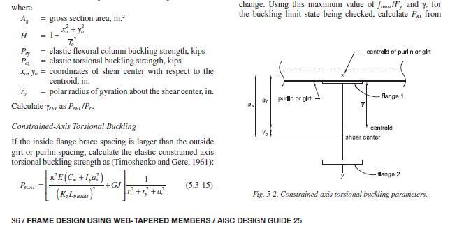

I'm with BA on this one. You're absolutely braced for weak axis buckling. The only question is whether or not you're braced for torsional buckling. And, given the torsional restraint provided by the floor deck and the fact that HSS sections are great in torsion, I'm willing to be bet that you're braced for torsional buckling too.
The most technically correct way to investigate this would be as constrained axis buckling (pic below). The results of such an investigation are generally pretty favorable with respect to strength. It's a fair bit of work however. In common situations where there are supported beams tying in at regular intervals, designers typically check unbraced weak axis buckling between beams instead of torsional/LTB buckling. This is done under the correct assumption that the procedure is conservative but not excessively so. For a beam that has no supported members tying in at regular intervals, there may be real economy to be gained by evaluating the situation more carefully.
