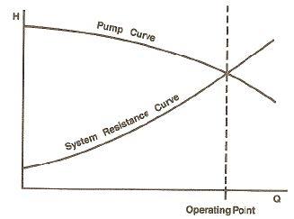

You should be able to obtain equal flow from the two identical pumps. However, to understand what will occur, you need to develop a system curve.
Overlay the pump performance curves on to the system curve to determine what to expect.
