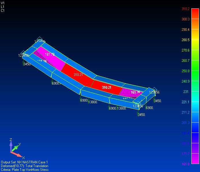

RE: Plate Deflection Calulation help
Hi jazz330,
We need more information like measurements, I assumed that is 1x0.2m welded in 4 corners, you will have problems because the deflection is 10.77 mm and von mises stress is 310 MPa. (I assumed that material is A36 too).
The plate is 3/16" Thick x 96" Wide x 240" High. The frame is made from 2"x2"x1/4" Angle Iron mitered and welded at the corners. The pressure is 8 psi coming from the side with the angle iron frame. All 4 sides are fixed not simply supported.
I have done hand calculations and FEA but I get a ridiculous value for Stress and deflection and I may be doing it wrong so any help would be great.
I don't see how a plate that big, with a so small thickness, could resist that pressure.
You should better describe the context and the goal of your analysis, as what you described is out of question.
Anyway your source is definitely the Roark, but also other sources online, google 'flat plates in bending' (example here, from the first site below).
If you insist with those dimensions and loading, you'll need to take into account the membrane action, and state whether the boundary is also fixed in the plane of the plate. Here a calc sheet for this condition.

I think that you must make a better drawing and post it.
I think we're jumping the gun to say "your plate's no good ..."
Assume a deflection of 1", then the plate has formed to a radius of 1152" = (48^2+1)/2
Then hoop stress is 8*1152/0.1875 = 50ksi; so it is looking dodgy,but then maybe 1" dflection is on the small side, given the scale of this plate. a 2" deflection would about 1/2 the stress ... 1/48, about 2% ... not unreasonable.
stiffeners running across the plate (96" long) provide lots of bending strength to the plate, and reduce the stress in the plate.
But, don't count a simple angle to fix the edge, even if you support the standing leg all around the perimeter; the angle would easily "open up". A tube section around the perimeter would give you more fixity (plate bending is torque of the tube ...)
