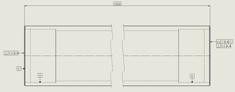

Hi all,
I have a fairly simple problem I think, but I am new to this and I think I am missing something basic.
I have a simple tube that I am trying to control the length of. Its ends are cut to a certain perpendicularity to its own axis (I have a good set of datums that allow me to define a datum axis along the length of the part). They are not necessarily cut parallel to each other.
How do I set up a feature control frame to measure length along the length of the axis? If I put a datum on one end and set up a position tolerance on the other, relative to that datum, then the datum simulator will end up taking up the angle of the lack of perpendicularity of the end it is on, and therefore the tolerance zone will do the same thing on the other side. That throws out the measurement.
Is there a way to reference the datum axis in order to 'measure along it'?
I definitely feel like I am missing something basic in the theory of setting up Datums for a part. I think I will be taking Y14.5 home with me over the weekend.

I'm not sure - does applying the length tolerance between the two perpendicularity controls indicate that the length tolerance must be measured perpendicular to those? If so, can you point me to what section of Y14.5 explains doing it that way?
What I want is roughly seen in the attached. All of those green arrows must be within the tolerance specified, with all measurements taken along the blue axis.
What is the graceful way to achieve that?

Another way might be:
Datum B could be assigned to one end of the tube with a perpendicular orientation control relatived to datum A.
A basic dimension from datum B to the opposite end.
A Profile geometric control could then be assigned to the opposite end of datum B, using datum A & B as a DRF (Datum Reference Frame)
Profile controls: form, orientation, size and location.

I think my second post should do the trick if you want to have perfect form and orientation at MMC. However, tight orientation control might be a manufacturability concern if your length dimensions is small. You can certainly further control the individual faces with perpendicularity callouts if desired.
Another thing worth considering is whether the datum could be referenced at MMB. If so, the part could be measured with a height gage after sliding it into a vertical tube-shaped datum simulator (getting back to the original question about measurement).
Anyhow, here is an illustration of the control that I specified above:
I suppose that I'd need some clarification if that's not what the OP is looking for.

Hi Guys,
I have read your responses and understood what I could - I suppose the issue I am having is that the perpendicularity tolerance I am using is quite large compared to the position tolerance (roughly half of the position tolerance is available for perpendicularity, on each side), This is compounded by the fact that the pipe is quite long compared to its width, so if an off square end is brought up against a flat datum simulator, then the normal distance to the end from the datum simulator becomes very different than the distance along the pipes axis.
I have thought about this, and I can control it if I can specify that the datum simulator be perpendicular to the parts axis. This is all possible with the physical part but the question is, how can I actually specify it with GD&T? I have a theory that I haven't used before as I am new to this, please see below:
I have previously seen, and not understood, tolerances given with respect to Datums that they cannot be measured from, for example, a hole position referenced from a datum plane perpendicular to its axis. Having just done some reading of Y14.5, it appears that what these datums serve to do, is to require the latter referenced datums to be set up in a particular way to create 3 orthogonal planes for the reference frame.
Therefore, here is what I want to do:
1) Datum axis established along the pipe based on bearing finishes on the pipe. This is what we want to measure along.
2) Datum on the face of one side of the pipe
3) Other side gets a positional tolerance with the primary datum being the axis of the pipe, and the secondary datum being the other face of the pipe.
4) Both sides get there own perpendicularity tolerances relative to the axis.
In theory this means the datum feature simulator for the secondary datum needs to be perpendicular to the axis of the pipe (first datum), and then brought in to touch the edge of the pipe. Does this all sound like it should work?
Thanks.

What you are looking for is to control the profile of the pipe ends relative to its axis. There is a symbol for that.
You can base the profile of each end wrt to the axis and a datum plane touching the opposite end; there will be a basic dimension between them.
There isn't a control in 'Y14.5 for the orientation of a two point measurement, though you can create your own note to describe the measurement method you want.
The use of a perpendicular face in a typical position tolerance is because the primary controlling factor for position is the orientation of the feature; then the location relative to some other feature. Position is also not applicable to planar surfaces.

Thank you very much everyone, I think with your combined responses, it has been resolved, and more importantly I have learned a hell of a lot. I have included a drawing of the part with all the unrelated stuff removed, please let me know if you see any issues.
RE: Setting up Datums, and controlling the orientation of a datum simulator or measurement
It looks like you have a tighter constraint on perpendicularity than length in your design per the sketch you provided. Perhaps those faces are sealing against something. If so, what you've got should achieve that goal.
A couple of notes:
  • Controlling your pipe to +/- 1/64" probably cannot be accomplished by saw-cutting. You will need to mill that dimension or cut it on a lathe.
  • Perpendicularity control of ~10 thou may also require milling or lathe cutting
  • The RHS profile tolerance/perpendicularity combo looks like a good opportunity to use a composite profile tolerance instead.
* Items in red updated in accordance with comments below
I don't quite understand what do we need datum [C] for?
First, datum [C] implies that functionally left end of the part is somehow more important than right side.
Second, when you give real part to quality control guy, how will he know which side is datum [C]?
To me specifying Profile of a surface 1.000 wrt A-B and Total runout .300 wrt A-B on both sides should do the trick.

Why Datum C ?
Basic dimensions need to be related (traced back) to Datum(s) (DRF)
CH's idea with profile wrt A-B only (without referencing to C) applied to both sides of the part holds water.
As an alternative to additional runout controls, two perpendicularity callouts wrt A-B can be used.

CheckerHater,
I guess that the figure you provided is illustrating the use of "all around" profile. Since they're treating the entire shape as a single profile with an all-around tolerance zone, only a single datum reference is required to establish perpendicularity. I don't think that's appropriate in the case of the pipe.

I am not really in the mood to start a lengthy discussion.
With Profile tolerance zone you know where the body of the part can and cannot be. That is usually enough to devise a gauge - there is no need for "physical stop to measure from"
And in practical world it would be more clear NOT to specify Profile - just toleranced length of the pipe combined with Total Runout requirement for the ends.
Also I don't believe the figures in the Standard are "incomplete" to the extent of concealing the truth.

I just want you guys to know I am still reading this thread religiously. Especially the part on profile tolerance without the full Datum frame. I'm not sure who to agree with right now so I'm hoping it goes on for a little bit longer for me to gather more info and form an opinion, as otherwise I will not know what to take from it.
I do agree that in the practical world it would be clearer not to specify profile. In fact in reviewing the part we tightened up the perpendicularity tolerance (the ends will have to be milled or machined for the bore, depending on the process the suppliers chose, so cleaning up the ends for perpendicularity is not going to be an issue), which has thus reduced the importance of ensuring you measure along the axis of the pipe. As such that length tolerance has been replaced with a directly toleranced length of pipe.
This was in combination with speaking to some potential suppliers here about the clarity of the symbology (we have to be careful about scaring off shops, as we have an exceptionally weak manufacturing industry here so not all shops are used to GD&T, not that I'm in a particularly strong position myself), and that one tolerance was the one that was flagged as "not sure why that is there". I explained the reasoning and meaning, but for every one that raises it with me there will be another that didn't understand it but doesn't want to ask.

But just like Nereth1 I am curious to see more opinions
- From the purposes ASME Y14.5 came into being over the years regarding dimensioning and tolerancing for commonality, practice, understanding, cost savings concepts, etc; for me has proven to be defined by who is wielding the checker pen and how much will it cost the company.
A man convinced against his will is a man that remains unconvinced....
Somebody famous said that censored
Quote (Nereth1)
...we tightened up the perpendicularity tolerance, ... which has thus reduced the importance of ensuring you measure along the axis of the pipe...
Hopefully your part tolerance is stackup driven. You could be making a more expensive part than necessary if you are arbitrarily tightening tolerances.
We judged it incredibly cheap to drop the tolerance on that one as the process to machine it is already going to be there as part of other processes - for example the edges are chamfered and just inside is a bearing bore. In all likleyhood, either it's a facing tool added to an already custom boring head, or it's another (fairly quick) motion on a lathe that is already right there.
As such, the actual justification was driven by "why risk it when it's so easy to get right" more than a serious investigation on how far we can push the tolerance. Our presses touch that surface during assembly and we don't particularly want to find out what happens if it isn't quite square. There's an arrangement of seals pressed in there as well and it seizes up quite easily when the wrong combinations of misalignment and mispositioning takes place.
Maybe not the perfect justification for tightening a budget, but a finite run of parts means finite resources to optimize the design.
