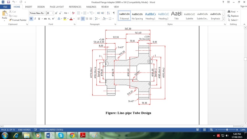

I'm trying to solve the total membrane stress intensity for the pipe-line tube in a flange adapter.
Rated working pressure = 10,000 psi
3 1/16'' x 4 1/16'' Flange Adapter.

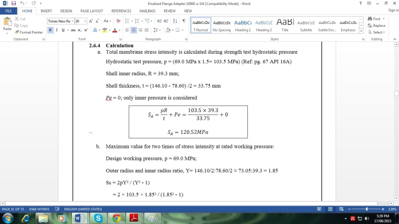

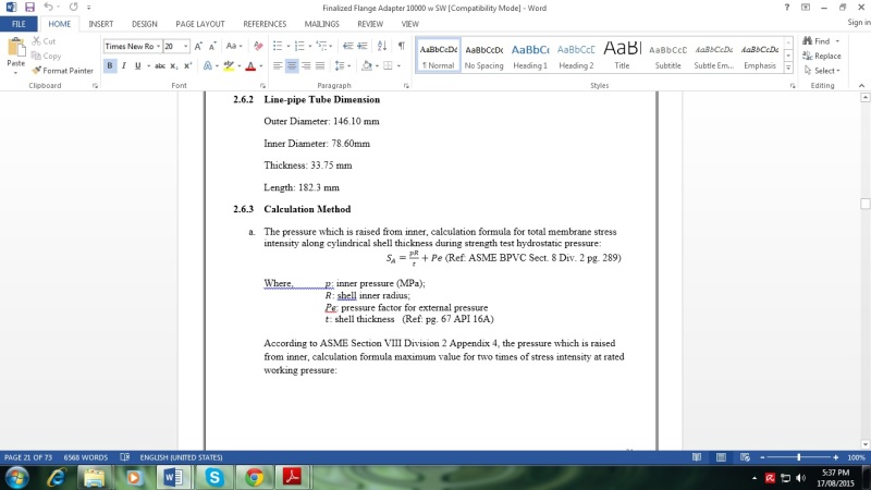

Hope these images would help and thank you so much for keeping up with me. dazed

You appear to beer using an internally generated calculation sheet for your company's pressure fittings. Whomever wrote that calculation sheet had (generally, in my opinion) poor English. Therefore, I can deduce that the terminology that they used is inaccurate. Furthermore, the calculation is not actually to find a stress intensity, but rather a hoop-direction stress component.
The calculation that is being done (p*r/t) is a thin-shell approach to calculating the average hoop stress in a cylinder. Based on the drawing that you included, I would definitely not say that your geometry is thin-shell. Furthermore, these calculations refer to an Edition of the ASME Code that is now 9 years old. As gilmiril indicated, that Division if the ASME Code was significantly rewritten in 2007.

Thank you so much for the answers. To start with, the design report or rather the design package was originally written by the previous engineer before I commenced, my job (as been instructed to me) is to find any mistakes in the calculations and to correct them. I do recognized that the p*r/t calculation won't be applicable for the design and that the phrase "total membrane stress intensity" is totally misleading here. Your responds do make a lot of sense now.
To conclude for now, can we say that the "total membrane stress intensity" isn't an appropriate value to be solved for? Or that "total membrane stress intensity" is just a typing/translation error?
RE: Total Membrane Stress Intensity
It is definitely a typing/translation issue.
It may be appropriate to calculate the membrane stress (principal or equivalent) for comparison to the allowable stress.
