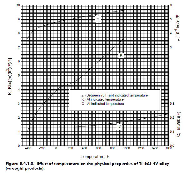

So basically what I want to know is this: how much will a 2.00/3.00mm circular hole drilled in 6al-4v ti (round stock outer diameter 15.00mm) expand at 1000deg C (in millimeters)? I'll heat the handles and cool the steel hex material (bondhus chopped L-wrenches).
I'm building hex screwdrivers out of ti (handles) and steel (tool tips) and I want to shrink the steel inside the heated ti and end up with a rock solid fit that will never ever turn/slip in the handle.

Don't know why you think this is a better idea than a wrench like this, but here you go: Below is the CTE (alpha) curve for 6Al-4V wrought titanium. At 1832degF (1000degC) the CTE is 9.6ppm/degF. So heating your titanium handle from RT (70degF) to 1832degF would grow the .1181" (3.0mm) diameter hole by .0020".
I don't know how you plan to heat the titanium handle to 1000degC, but it would be best to use an electric furnace. Using a torch to heat the handle in open air would be dangerous since titanium burns very energetically and is a very difficult type of fire to extinguish.

Yeah, regarding the heating of ti. if I drill a hole that would be 3.00mm it would expand to 3.05mm at 1000C. and its highly uncertain the actual 3.00 hole would actually come out at 3.00. most likely it would come at at between 3.00 and like 3.05. and that is the exact same tolerance that the actual ti would expand to. so in reality this would probably never work.
Unless... :)
I do a 3 piece approach. first steel hex tool tip. Then either brass or bronze middle part (it has 3x the thermal expansion of 6al4v ti) and then outer part ti (the part you hold in your hand).
I was thinking the middle part could be bronze with a drilled hole of 3.10mm nominal. and that would expand to like 3.25mm (3x more than ti would) and then I can fit the hex 3mm in there.
And then when step 1 is done I move to step 2, and that is fitting the brass to the 6al4v. But now the brass outer diameter is like 10.00mm instead. And obviously I could do more things now with low precision machines since i have a material that is 3 times as "thermally expansive" and its 3x the diameter to begin with. win-win imho.
so yeah thats pretty much what I'm going to do here. use a middle bronze piece. pretty much.
