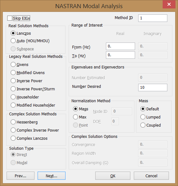

I need to obtain the stiffness and the mass matrices from 2 different FE models, one is meshed with solid elements and the other one with shell elements.
I created the 2 meshes with virtualab, exported as a .dat file, performed an analysis with nastran and, with a matlab routine, I red the matrices from the .pch files.
To validate this procedure I am simply calculating the natural frequencies of the two models both with virtual lab and with matlab.
My problem is that the matching between the frequencies of the shell model, when calculated in matlab and in virtualab, are completely different: in matlab I obtain only 3 rigid body modes (instead of 6), the first flexible mode is at a very low frequencies (10 times smaller than the frequencies obtained in VL), and the other frequencies only have the same order of magnitude, but the error could be very important (from 50 to 100%).
Just to make everything more clear, I modified the exported (from virtualab) .dat file adding before "BEGIN BULK DATA":
SOL 103
PARAM,COUPMASS,1
PARAM,EXTOUT,DMIGPCH
The shell elements are CQUAD4, in the shell property PSHELL I have membrane effect, bending effect and transverse shear (as well as the thickness of the element, obviously); material is steel.
I read the .pch files from the 2 models with the same matlab routine.
In matlab, I tried to calculate eigenvalues in different way, just to be sure, and results are always the same.
I've already looked for some solutions in the forum but I didn't find anything... Does anybody know how to solve this problem?

Does your Matlab routine calculate normal modes for a free-free situation (i.e. no model constraints)? If yes, then having only 3 rigid body modes would be an indicator that this calculation is not fully correct. There should be 6 rigid body modes.

The normal modes/Eigenvalue (SOL103) solution should be the same, not matter you use VL or NX NASTRAN, or any other FEA code, this is a basic FE analysis, then some options regarding mass considerations (lumped or coupled), or the eigenvalue extraction method used, etc.. could be the reason of the differences in eigenvalues results.
Simply define a test problem of a cantilever beam, post here the details (dimmeensions, materias, BCs, etc..), and I can run the problem using FEMAP & NX NASTRAN and post the results here, OK?.
Or post your nastran input deck (*.dat) here and we can take a look to it.

I have already tried to change options about mass, not about the solution methods (I'm always using default options in nastran, which should be the Lanczos algorithm for a real solutions); by the way, I also used another solver (samcef), and results are the same obtained with nastran.
At this point I think that the problem is on my matlab code, also because I'm calculating eigenvalues in free-free conditions; I really don't know if it is due to the inversion of the mass matrix or to the calculation of eigenvalues, so I think I will write from zero the algorithms (maybe matlab functions "eig", "eigs", "inv" ecc. are optimized in a way that can affect my result).
Let me know if you have any other ideas please (anyway, if I won't forget it, tomorrow I will post my nastran input deck).
