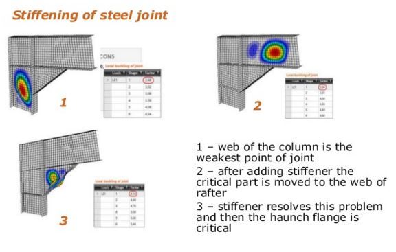

You can do buckling analysis, yes.
RE: Theoretical vs Actual Boundary Conditions
As I understand it, you are not designing actively for the buckling mode, but determining when buckling stress takes place and then adding a stiffener to preclude the buckling mode?

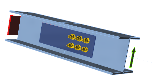

Since it's impossible to elaborate this in the context of an email, I will try to demonstrate this in an IDEA Connection model.
I create the following model of two HEA 200 beams. I connect them with a very thin plate (4mm) and a lot of strong bolts to ensure that they will not fail, and also that the bolt hole will not fail. Then I apply a big enough shear force.

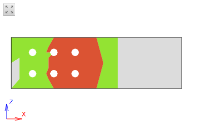

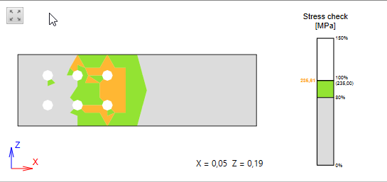

The equivalent stresses check in the plate (which take into account shear stress) have the following distribution:
Green part is over 80% and yellow parts are above the limit. The shear rupture failure is clearly located in the yellow area and passes through the bolt column.

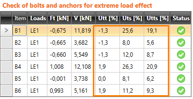

Since bolt utilization is low (picture below) we know that they do not fail

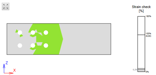

But in the end we see that the plate is also not failing since the strain of plate is quite low.
Which is not the case if I double the acting shear force
To conclude, our global criterion is the strain check (this comes from EN 1993-1-5 material model and experiments)
