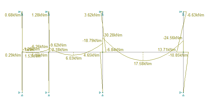

Hi guys,
I try to design a flat slab and at punching shear check i have to use the unbalanced moment. Please help me understand what is the unbalanced moment and how do i calculate it. Thank you
RE: What is the unbalanced moment
The unbalanced moment is simply the moment that is drawn to a column in a column slab/beam assembly.
If you imagine a three column frame perfectly symmetric with respect to geometry and load, there would be no rotation at the center column joint and thus no moment would be drawn into the column. The moments on either side of the center column joint would "balance". Now, if you take that same frame and make one slab/beam span twice as long as the the other, the moment on either side of the center column joints would be unbalanced and a portion (not all) of that unbalanced moment would flow into the column via eccentric punching shear and flexure in the slab/column joint.
Functionally, the unbalanced moment is represented by the vertical step in the moment diagram that manifests itself where the slab/beam system passes over the columns below.

Oh thank you very much KootK for your help. It seems very logic what you said, thank you very much. I have understood very well what you explained, for gravity load type, but if i have, say on that frame you draw, lateral load, seismic load, what moment diagram (only for seismic laterla force) will look like this :
That vertical step you are talking about is very large, the theory you said, can be applied here ?

Quote (OP)
Absolutely. In fact, your findings highlight the Achilles heel of the slab/column lateral system: moment transfer at the joint. In my opinion, when flat plates/slabs are used for lateral resistance, the joints should be designed in a more rigorous fashion than we typically do for Gravity loads (Link).
If you're doing a 2D analysis instead of plate element FEM, make sure that you're using something akin to the equivalent column method to capture the fact that the column/slab moment connection is quite flexible. That will bring your moments down a fair bit.
