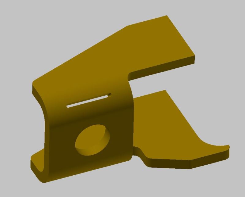

@berkshire, that was a hypothetical extreme case. I guess I'm wondering at what point the thinning becomes the cause of cracking on the outside radius. Here is the long-awaited specimen:
We have noticed that extending the slit so that there is only 1/2" width material left at each end, we get cracking on the outside radius. Material thickness is 3/8" and inside radius is 1/2". I am just looking for information on a minimum width/thickness ratio for bending mild steel, if such a thing exists. Just a thought, maybe the slit doesn't need to be on the bendline, but closer to the hole?

Ok, you already know that bending the part will stretch the outside of the bend and compress the inside of the bend.
The shorter the bend line the more extreme this effect is. One of the aggravating factors is that unless that part has the bend line supported by a sacrificial plate, the bend is not going to look like your drawing. it is going to be a straight line on either side of the slit, with an extreme amount of thinning, and tearing around the ends of the slot.
If you can support the bend , you may be able to make this part, otherwise put the slot in after.
If the slot is there to make the part easier to bend , get rid of it.

The slit is there to prevent deformation of the hole and is supposed to be welded shut afterward. I am pretty sure this is a common practice. Now I'm wondering if the slit should be closer to the hole and not right on the bend line. The fab shop is pushing to make it a 3-piece welded part. Right now they are grinding out the crack and welding the full length anyway.
I like your sacrificial plate idea. Thanks for sharing your thoughts.
RE: Minimum bend flange width (not length) for mild steel (ie. ASTM A36)?
Another option would be to remove both the slots and the hole to get good bends then go back and make the hole with a secondary machining process. Or cut a much smaller locating hole with the laser and go back after bending to drill to finished size. This would save welding and grinding, but you will have to talk with your fab shop to see which route ends up being cheapest.

I agree with hendersdc , Or cut a much smaller locating hole with the laser and go back after bending to drill to finished size.
Get rid of the slot and put a Pilot hole in. It will take you far less time to drill a hole than re weld that bend line.
If you want to punch the hole and you have enough of them , you could grind up a punch with a pilot pin for an iron worker to enable you to punch that.
