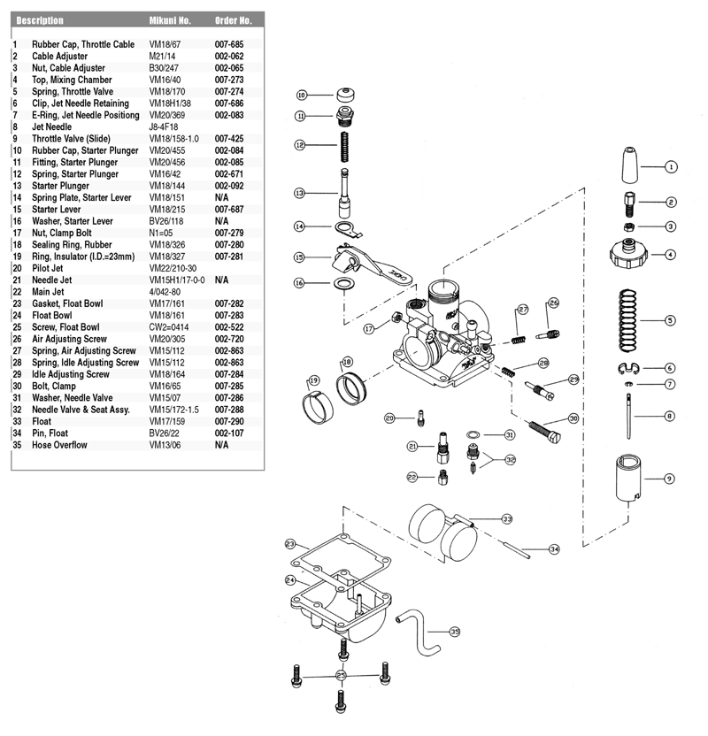

Some applications provide a shallow counterbore step or well with a diameter close to the E clip installed OD, and a shaped wire or cover plate and a spring to keep the clip and the retained device from moving out of the c-bore.
Needle retention in Slide type carburetors come to mind, I think.
Item 5, 6, 7, 8, and 9 here -
http://www.sudco.com/Diagrams123/expvm018.gif
or items 6 > 10 here -
http://www.sudco.com/Diagrams123/expvm.gif
view of clip on the needle 2:10 here -
http://www.bikebandit.com/aftermarket-parts/motorc...
for some reason all the pictures of the slide I found on line show the underside, not the top where the shallow counterbore is. ( If I recall correctly )
