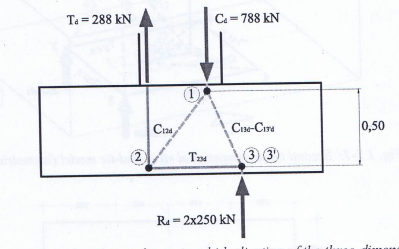

It's instructive to consider your situation turned upside down in which case it becomes very similar to a roof slab to column connection. And, like that connection, the Achilles heel of it is moment transfer through the joint. If the punching shear equivalent of P/A + M/S resulst in no net tension in the joint, then a punching shear check as you described in your initial post is appropriate.
If there is net tension, however, then I question whether punching shear is truly the appropriate check to be applied. In such a situation, I recommend strut and tie joint design in place of punching shear / sectional flexure design. To execute the strut and tie design profitably, you'll probably want to set up a spreadsheet. The illustrations below show an example of an appropriate strut and tie model as well the kind of detailing that results. However, as a proud North American, I don't hook my footing rebar at the ends.
