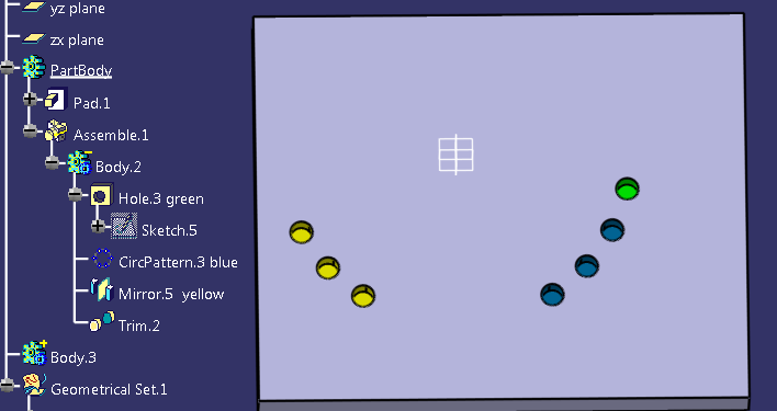

So I'm stuck. I made a circular pattern of object A, which gave me object B. I want to mirror Object B with my mirroring element being a plane. But, even if I only select Object B, It mirrors Both A and B. Please help.
RE: Mirroring an object from a circular pattern
i did not find a way to transform a pattern without applying the transformation to the source.

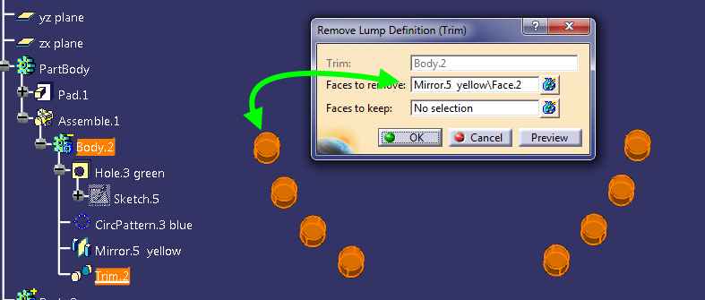

but you can use remove lump function after the mirror if you put all that in a sub body.
Eric N.
That's awesome! where is the Remove lump function?
