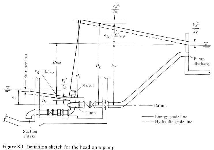

For typical inlet conditions, the energy density associated with the pressure will be dominant on the input side.
Use the Bernoulli equation to determine the energy based on velocity. The "stagnation pressure" is equal in the tank and pipe. Stagnation pressure is defined to be what you would get if you took the pressure and kinetic terms in the Bernoulli formula and calculated the pressure that would give the same total value all by itself (i.e., if velocity were zero). This is higher than the fluid's actual pressure, due to the effect of fluid velocity entering into the tank and coming to a stop.
If you look at the sketch below, the kinetic energy is shown as v2/2g.
