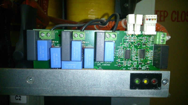

Guys I ordered new HF controller module as well as fan supply module from Schaffner. However, the parts I received do not look the same to me. The part numbers were different from what we ordered so i rejected the modules. Then the supplier gave guarantee that the parts were same with different numbers. I have attached pictures of existing modules and the new ones. Any suggestions would be helpful as I am confused. The fan module card is physically bigger and has a different mounting orientation The controller module card has different number of jacks.

Thanks for helping. Please see the pictures now. What do you think?
Existing controller module
New controller module
Existing Fan supply module
New fan supply module
