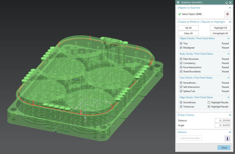

Here is another problematic file. I used the Examine Geometry to find "bad" edges.

Short answer: No, the visualization facet settings do NOT influence the geometry that is exported.

Rule #1: make sure the geometry that you are exorting is valid.
Before exporting anything, be sure to run the examine geometry command. When selecting objects to check, make sure to window select around the entire model; this will ensure that you have selected the solid body along with all faces and edges (single selecting the solid won't get it all). If the geometry that you are exporting is a solid body, it should pass all the "body checks". If any of the body checks don't pass, don't expect good results after the translation. The "self-intersection" test under "face checks" is also a "must pass" type of test. The other checks are of lesser importance.
I imported the first parasolid (bad_geometry.x_t) into NX 9 and it did not pass the face: self-intersection test. NX indicated errors in the same location that SDETERS' file had issues.
The "optimize face" and "heal geometry" can be used in an attempt to clean up the geometry. If you have a fully parametric design in NX and depending on your business needs, you might prefer to edit the model to clean up the geometry yourself.

The modeling tolerance, for a given NX part file, can be found by going to: menu -> preferences -> modeling. The distance and angular tolerances will be listed on the "general" tab. Some features will let you specify the tolerance to use for that feature; don't change the tolerance for individual features unless you have a very good reason to do so. I think the default modeling tolerance in NX was tailored to the automotive industry. The values work well for a variety of industries, but if you make something much much larger or much much smaller, you may want to adjust the tolerance to suit.
