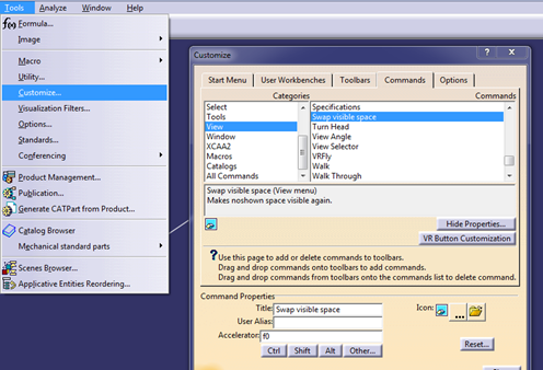

Hello Guys,
Is there anyway to check the list of hotkeys that have been set in CATIA ?
Either default or custom done !!
Warm regards,
Akhtar Aziz

RE: Check Hotkeys
SORRY
in fact I should have looked your question and the provided answer....
the all command functions in the view menu does not list the shortcuts upsidedown
you have to go in customize function and then you have access to the shortcut info:

RE: Check Hotkeys
If you know a little vbscript you can search in CATRsc files something like (bellow is just an example)
// Shortcut
ACOClaCreationWbenchHeader.FSFlipCompassBaseHead.Accelerator = "F5";
ACOClaCreationWbenchHeader.FSSetCompassHead.Accelerator = "F6";
ACOClaCreationWbenchHeader.FSResetCompassHead.Accelerator = "F7";
// meme short-cut utilise par MainDialog pour modif de selection
//ACOClaCreationWbenchHeader.FSDropCompassPlaneHead.Accelerator = "F8";
So, search inside those files keyword Accelerator and extract all the lines in a list (then you can share with us if you want). And indeed , I've done a confusion, in v6 you can see the shortcut keys in Commands List pull down menu...
