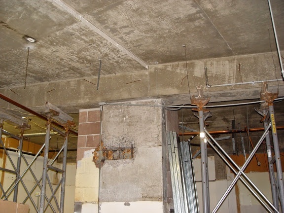

Yep, Some contractors do some idiotic things.
We found this RC column - that supported 12 floors over - 50% of the area was chipped so a dumb-waiter sheave beam could be installed. Some column longitudinal bars had buckled!
