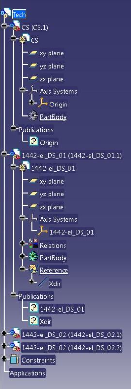

I have one level assembly with multiple parts and their instances on different positions. Parts already have published elements (lines and axis systems) that are needed to be copied in (empty) part called "Positions" which is in the in same assembly, so the position of copied elements doesn't change, and also their name should be same as in source part.

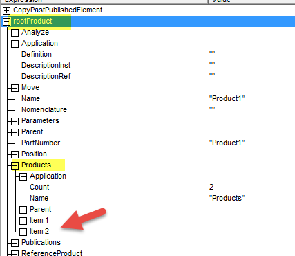

I hope I understood correctly, as you can see in code below, I used For loop to run trough all parts and their instances in assembly, and for now just output part's names when loop is running(for check).
Additional question at this point is, if I can limit parts used in FOR loop to only visible parts?

RE: Copy & Paste published elements in context
your FOR loop will go from 1 to rootProduct.Products.Count visible or not
What you can do is check if rootProduct.Products.Item(i) is visible or not
the visibility is given by selection.VisProperties
CATIA.ActiveDocument.Selection is the selection, once you define the selection object you can add, remove, copy, paste...
Can you debug.Print only visible instances?

Can you post a picture of the tree structure showing the publication and eventually the geometry to be copied?
Did you manage to select your geometry? is you geometry always the same name in the same geometricalset? or the only way to find the geometry is from the publication?

Here is Tree structure of my parts, and all parts are created from template part (new from), and in this case it already has published elements like axis system and line. It is important that copied axis system has same name as source part.
file from a temple is a good idea, it will make the selection easier...
your code still don't do the selection of the element for copy...it should not be that hard...
Eric N.
