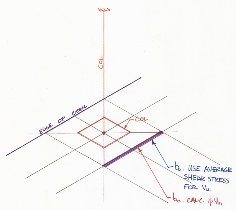

This is allowing us to check one direction at a time[/b], x and then y....
I interpret this differently. I think that this allows us to calculate stresses, one at a time, about the geometric axes and then superimpose them for a biaxial check. I see no rational basis, nor code support, for checking punching shear about each of the geometrical axes separately and not combining them somehow for a bi-axial check. That being said, I routinely see designers doing exactly that. I think that a lot of folks mistakenly assume that, because moment can be considered independently in the two orthogonal directions, the same holds true for punching shear.

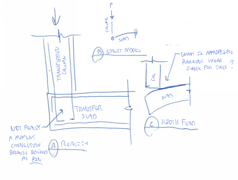

I know of one large company here that models all edge and corners as pinned for the same reason you stated, that there isn't sufficient moment transfer.
This one really makes my head hurt. My understanding is that punching shear checks are one half of a joint design of which the other half is a proper flexural design (Link). If you essentially disregard the moment transfer altogether, how valid is your shear check? Extreme versions of this happen at roof columns and transferred edge columns on transfer slabs (sketch below). The faux pin assumptions lead designers to check punching shear based on load transferred through the center of the column when, it seems to me, the point of load application would be closer to the interior column edge. Interestingly, this would often move the point of load application closer to the centroid of the critical section. But then the columns would have more applied moment.

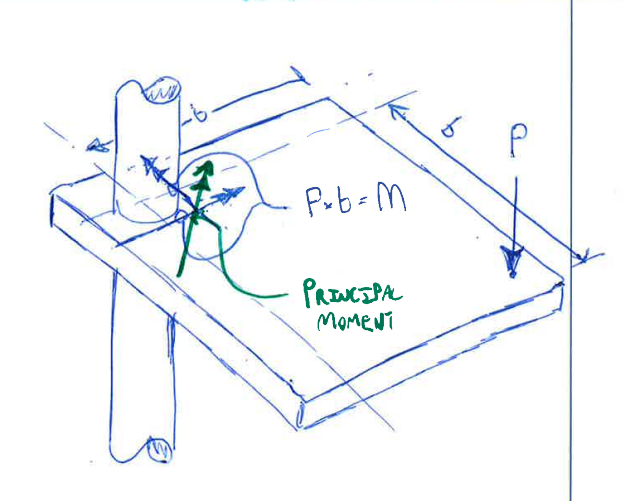

Below is how I've typically modeled this scenario with columns below/above. The case below is a footing where the maximum punching shear stress (P/A +/- My/I) is away from the edge which is typical. It is a moment connection. I don't understand why this would be a pin/hinged connection.
For a corner, I don't see why the calculation should be different. Stress transformation, principle axes, and Mohr's Circle shouldn't apply because this is a strength, not stress, calculation.
As a disclaimer, this is just how I've approached the topic. I have no justification for this other that this is how I initially interpreted the codes.

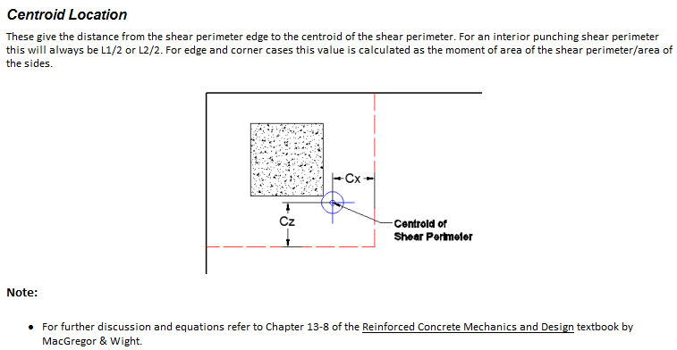

2) When calculating max stress location, it is important to remember that the centroid of the shear perimeter changes when you have a corner case. See below image from our help file.
This has a significant effect on the J value used in the calculation of max tress. The eccentricity between the center of column and centroid of punching perimeter also creates a moment for the calculation even when no moment is applied from the column.
3) We calculate the total stress as the direct shear stress + shear stress due to moment. So, this will always occur at one of the corners of the perimeter. I think this is the intent of the code, though it is not as clear cut with corner columns as it is with edge columns. I tend to look at it as an "unzipping" of the punching shear perimeter. The stress is high enough that the concrete cracks at the max stress location in the punching shear perimeter. Once the crack forms, the resistance decreases and the crack propagates to the lower stress locations.
