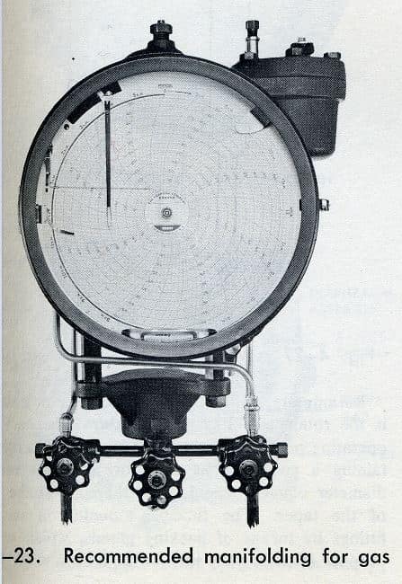

For an illustrated view of manifolding prior to process manifolds, check out the book Industrial Instruments and Control Piping for steamfitter pipefitter
first published in 1961 by the Nat'l Joint pipefitter apprenticeship committee. It covers pneumatic instrumentation because the 1961 era was pneumatic
instrumentation. Since it was 30 years between the original publication and the early era of the electronic pdf format it is unlikely that there is a pdf format,
uncles someone has scanned a copy and converted it.
Typical exemplar:

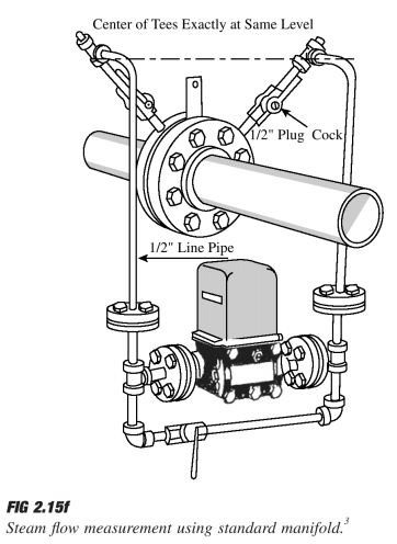

I'm an old guy, but I'm too young to know the origins of process manifolds.
Liptak uses the term 'standard manifold' as shown below (Instrument Engineers Handbook, Vol 2):
I suspect the integral valving of current process manifolds took a big leap forward with the standardization of the 2 1/8" center-to-center process connection dimension for pneumatic DP transmitters (1940's? Liptak, pg 548, Transmitters - Pneumatic)
A patent application (URL below) describes the origin of the 2 1/8" dimension (as it relates to taps for an orifice plate for DP flow measurement) and it lists some prior art patents, which might shed some light on 3 or 5 valve manifolds used for DP flow. Good hunting.
