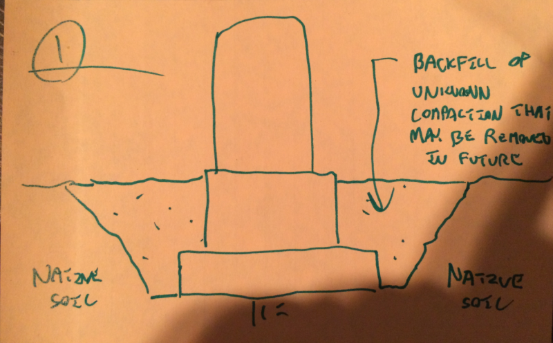

@fattdad: you've helped me out with a number of geotechincal issues in the past and I have a ton of respect for your geo-chops. That being said, I disagree with you quite strongly on a few points here. Granted, I'm no geotechnical engineer. However, I've designed a lot of structures for overturning and, if you don't fight above your weight class from time to time, learning comes slow.

I would calculate the passive pressure and show the triangle as depicted in the sketch
It surprises me that proponents of using passive pressure rarely have anything to say about the fact that back fill, of unknown compaction, is involved in that load path. See sketch #1 below. It seems to me that the passive soil pressure of interest would be that associated with the back fill rather than the native soil. And it's a pretty safe bet that the Kp in the soils report, should one be forthcoming, will be the value appropriate for the native soil. On a few occasions, I've asked my geotechical consultant for Kp values for back fill. In all cases, the answer has been something like "uh.. maybe it would best to just not count on that unless you're back filling with lean mix concrete".

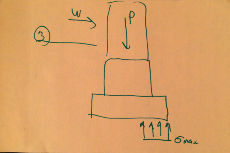

RE: Passive Pressure and Shallow Octagon Foundation
Quote (hitch22)
The soil is failing under bearing at the toe due to a high eccentricity. For example, e/D=0.36.
In my opinion, stiffness incompatibility makes it is unreasonable to use the passive soil resistance to shield the soil from vertical bearing over-stress. See sketch #2 below. The springs representing vertical bearing stiffness be pretty stiff, particularly given your allowable stress. The springs representing lateral soil stiffness will be quite flexible, initially, until enough movement has taken place to mobilize passive resistance. I'd be willing to wager that you'll over stress your soil in vertical bearing long before passive resistance is fully mobilized.
Oftentimes, allowable soil stresses provided by geotechnical engineers are established to mitigate differential settlement. As such, two things may be possible with the help of a geotechnical engineer:
1) You may be able to use higher allowable for transient loads such as wind and/or;
2) You may be able to use a non-triangular stress distribution as shown in sketch #3 below.
