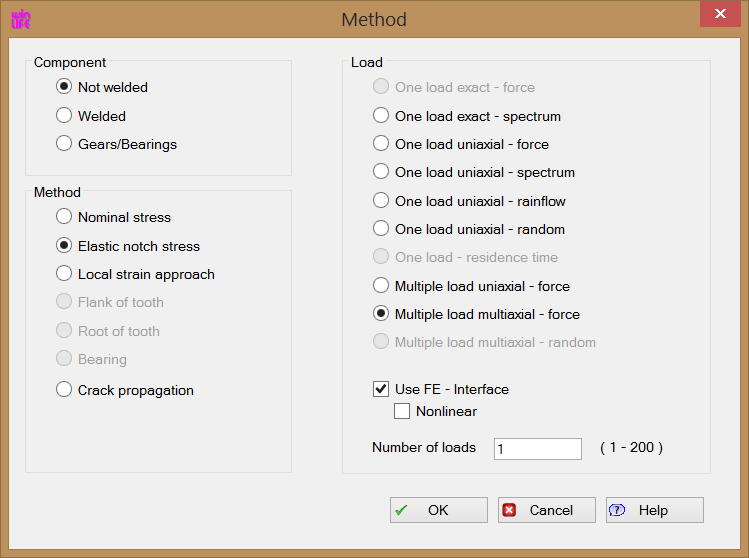

When calculating stress with at a notch, FEM give us nominal stress (time) theoretical stress concentration alpha (or form factor). Do you guys recalculate that stress using fatigue-stress-concentration and other corrections not accounted with FEM?

To do a fatigue life calculation in any fatigue code (for instance, winLIFE) for "not welded components" the following three basic methods are available:
• The Nominal Stress Method
• The Local Stress Method (also named the Elastic Notch Stress)
• The Local Strain Approach.
In the Nominal Stress Method the user has to calculate the nominal stress acting in the critical cross section of the component (the noth is not meshed in detail in the case of using FEA). This means, that the user must have an idea of the critical point(s) of a component (for components with simple cross sections this can be done easily, for complex geometry a simplification is required to define a suitable nominal stress). A nominal stress is defined by simple equations and the elastic stress in a component can be calculated by multiplying with a stress concentration factor. A calculation can be done, if the stress concentration factor Kt is known. Then the value of stress concentration factor Kt is used to define the S-N curve of the component, as well as material properties, treatment of the material, surface, etc...
The Elastic Stress Method uses local stress to perform a fatigue life prediction according to S-N-curves. The procedure is similar to the Nominal Stress Method but the S-N-curves are not related to the component but to the local material. This means that the stress concentration factor is not needed, because the local stress is used. Local effects can be considered by using the surface roughness, stress gradient and supporting effect, then Kt = 1.0. Usually FE results are used for the notch stress analysis and you get a stress tensor with 6 components at each node. Therefore it is necessary to take one size from these single stresses, one that is suitable for the fatigue life, an equivalent stress or a damage parameter.
In the Local Strain Approach -contrary to the Nominal Stress Method- the real stress and strain are needed at the locus of interest. This can be calculated by the FE-method. Because of the calculation performance, an elastic stress-strain analysis is usually done and the stresses are transformed to the real stresses using Neuber’s rule.
