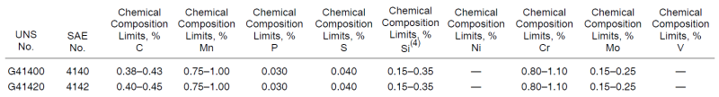

I have a print for a housing that calls for 4142 H.T. Having trouble finding this material, but being offered 4140 H.T. What is the difference?

From SAE J404 Chemical Compositions of SAE Alloy Steels and SAE J1268 Hardenability Bands for Carbon and Alloy H Steels:
RE: 4140 ht verses 4142 ht
For AISI 4140 versus AISI 4142 the only main difference is the carbon content, and it's pretty small. The balance of the chemistry is the same. The elemental compositions can be seen here:
Carbon 0.38 – 0.43 for 4140 versus 0.40 – 0.45 for 4142
Manganese 0.75 – 1.00
Phosphorous 0.035 Max
Sulfur 0.040 Max
Silicon 0.15 – 0.30
Chromium 0.80 – 1.10
Molybdenum 0.15 – 0.25
Maui

Many mills will dual certify their 4140 as 4140/42, meaning it meets the chemistry requirements of both 4140 and 4142. The same would be true as 4140/42HT.
See if your suppliers can find some dual certified material.
I have ordered the dual 4140/4142 HR HT
