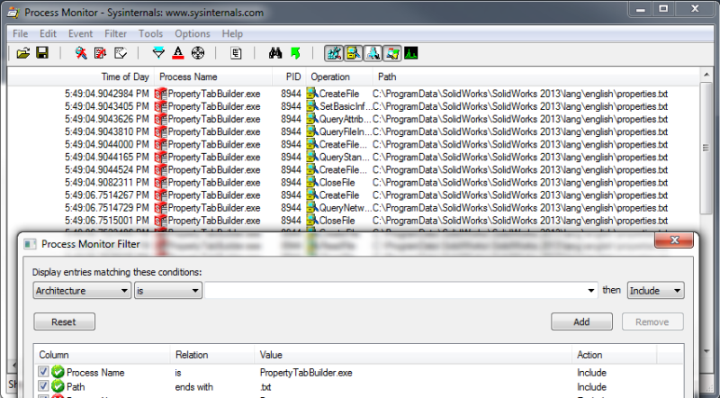

I was thinking you could use Process Monitor to figure out what file the property tab builder was opening. Given what I found on my system, it might help. The shot below is from starting Property Tab Builder 2014. It is reading the properties.txt from my 2013 install. I just checked inside of SW 2014 and the path there is to the 2014 folder. I exported my sldreg file and checked that there were no 2013's in any of the paths. I do not know where the property tab builder is getting its path information from, but it does not seem to be affected by the SW setting. My guess is that it is based on the path that was last used to open or save a properties template. Either way, having Process Monitor tell you the path of the file that is being read might get you through your short term problem.

How are you getting that to show up. I set those same filters up and I get no hits when I launch the Tab Builder, add a "List" box, browse to the actual *.txt file and select a property. Some for a "Textbox" and select a property. ProcMon shows nothing in the program.

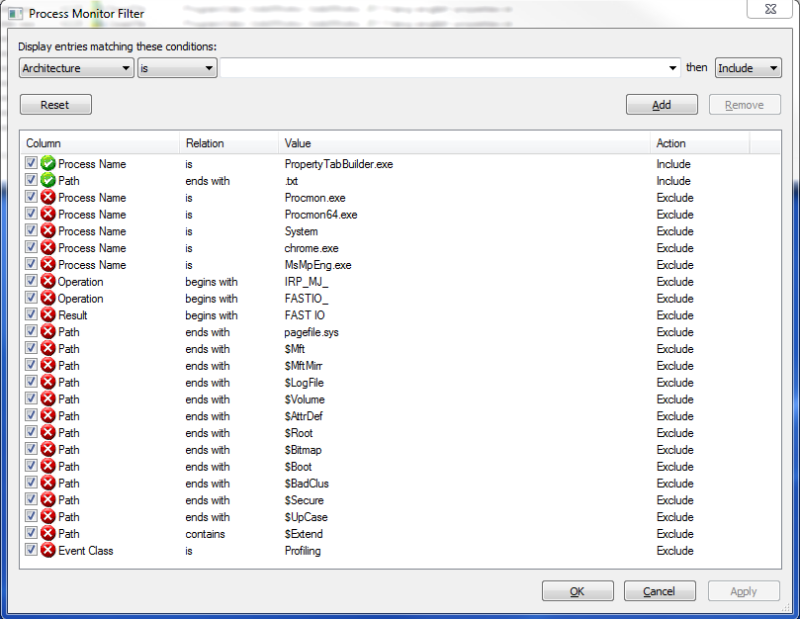

I have Process Monitor running with the filters set up and it set to capture events. Then I start Property Tab Builder 2014, and all of those appear right off the bat. The values are a bit hard to read in the screen capture so I'm including the text here. I am using Process name is <PropertyTabBuilder.exe> and Path ends with <.txt> (ignore the <>'s). Here is the full set of filters. I would start with just the process name one to make sure you are getting something.

Remove / uncheck the filter for Operation is RegSetValue. It is requiring the operation to be setting a value in the registry when we are looking for it accessing something in the file system.
